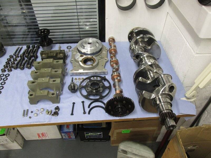

Here is a pic from their FB page of an engine build (Hemi) and you can see in the lower left what appear to be cam buttons. Even if they aren't, look at the timing cover with the access hole to establish end play by using either a cam button or another method of control.
This just may be a gear drive....no cam button. But is that their answer to no cam buttons?
If you have a BBM with a dry sump system, and a crank trigger ignition, you have no intermediate shaft
so nothing to keep the cam up against the thrust face on the block. Only reason to use one.
Hughes cam, contact Hughes about what to do. They may exchange it. Nothing to lose but the phone call. Ask them about the buttons. They are a cam manufacturer and should know.
I went back to look and it is a gear drive cover, but the cam end-play still gets established with a gear drive also.

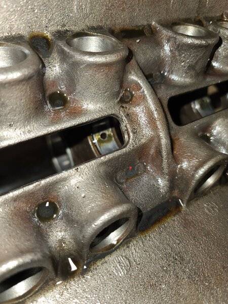

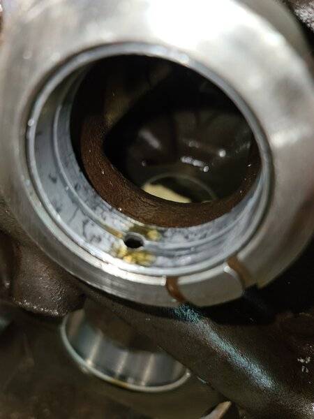

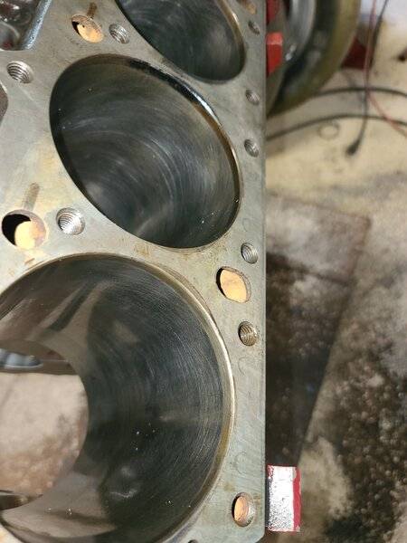

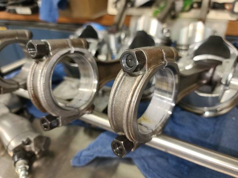

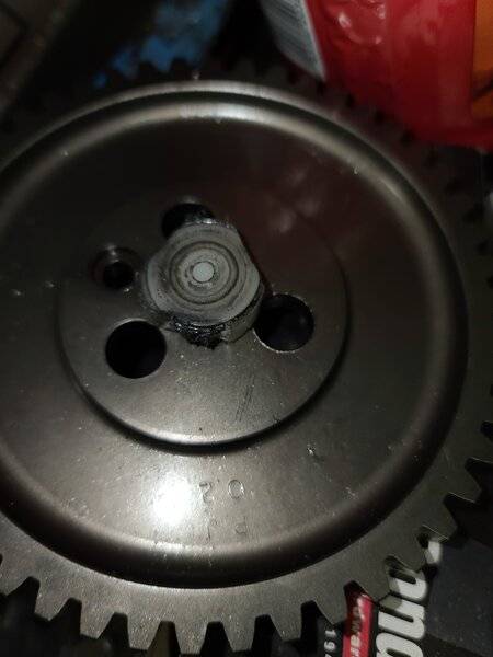

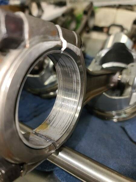

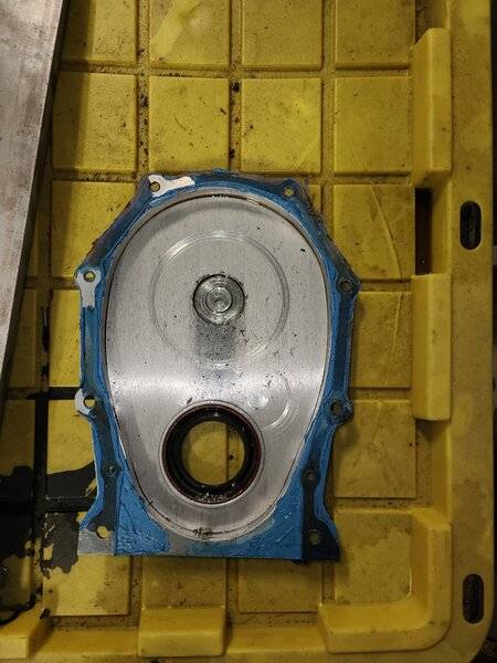

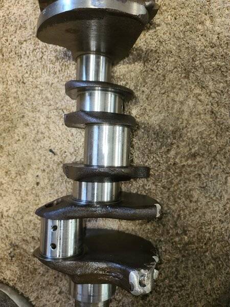

Took some pics this afternoon..
20210623_151443.jpg 20210623_151649.jpg 20210623_151900.jpg 20210623_152015.jpg 20210623_152001.jpg 20210623_152021.jpg 20210623_151917.jpg 20210623_151908.jpg
Well got some good news this afternoon. Dropped the block off at the machine shop, said the cam is fine, crank is fine.
They are going to jet wash, it check the deck, bores ( they think they are fine looking at it) , hone it & install new cam bearings.
May have dodged a bullet and purchasing the ARE cover won't hurt as bad!
