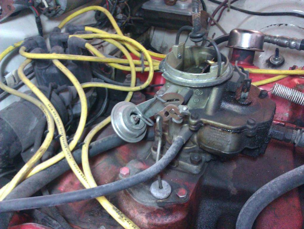

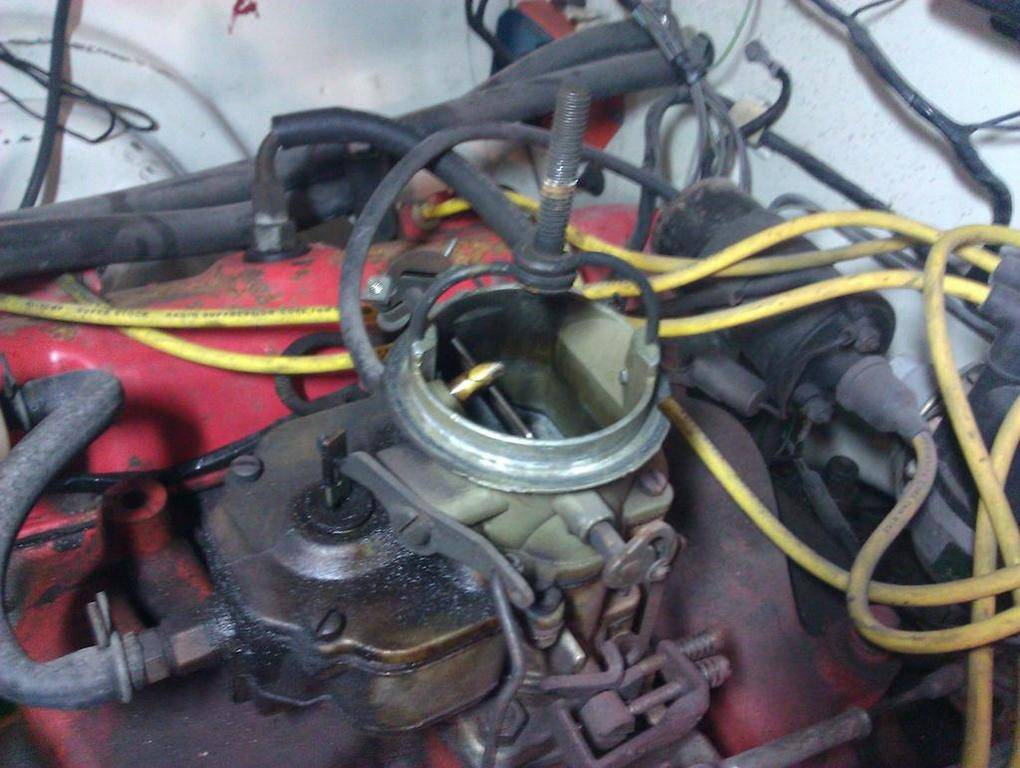

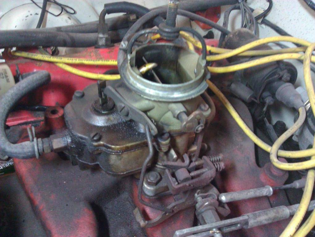

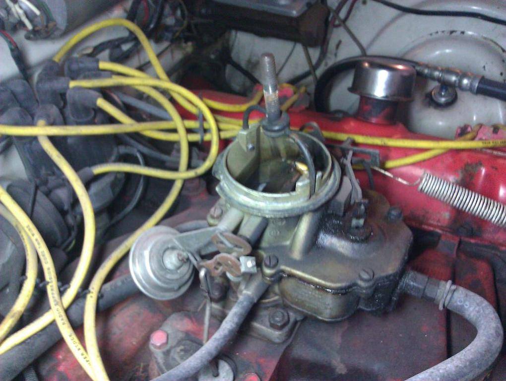

Here are some photos of what everything looked like:
It looked like this after a cold start before I set it:
It looked like this after I set the choke after the same start when it had warmed up enough:
Notice the vacuum diaphragm is pulling on it:
Then here it is with the car shut off:
Not fully closed but pretty close to as closed as it gets:

From the picture the choke pull off is pulling the choke flap open too far. For a normally working choke you should have some spring tension with the engine cold and the choke pull off only should crack the blade open a little - against the spring tension. It's possible someone adjusted the choke so it stays open because the manifold never get's hot enough to heat the bi-metal coil that normally opens it.
With the engine running for about 10 minutes you should be able to check the temp of the choke well to verify if the heat crossover is blocked. If it's blocked it may be warm but not hot.
