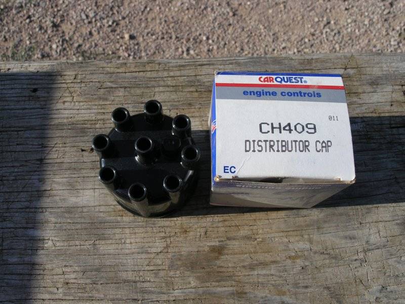

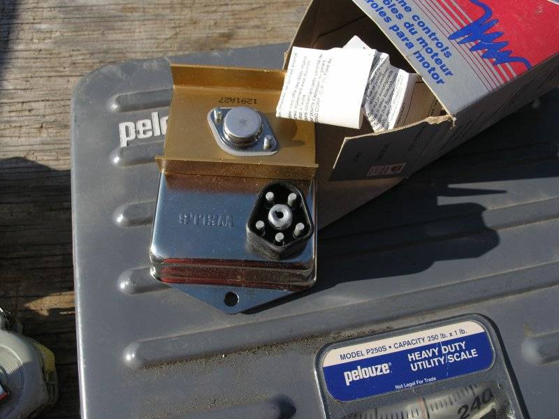

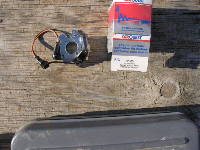

Got these at a farm sale. Will they replace points?
Partially. You still need a electronic distributor and wiring harness along with a ballast resistor.
Why couldn’t you remove the points breaker plate assembly and replace it with electronic plate and set the air gap with the brass feeler gauge as per spec? Ballast avail at parts store

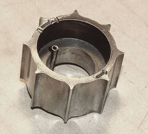

Because you cannot trigger the electronic pickup with a points cam. You need a Reluctor. Will a reluctor swap onto a points distributor shaft? I don't think so, they mount differently.
Thought it odd no one makes a simple points dizzy conversion to Reluctor/Sensor similar to the Pertronix Ignitor Conversion set where an added Reluctor Ring fits over the points cam...Or maybe there Is a Points to Reluctor Conversation kit I'm Not aware of ??
The Reluctor cam will fit on a point shaft and vice versa. Mount exactly the same. Cap and rotor same too. That is the 5 pin so you need the harness, the reluctor cam, the dual ballast and you can convert your system.

Is this Module Chrome or Gold. Seems to be half and half. The box also came with 7mm wires and Autolite 85 plugs.
Hey D Slayer,...As I've not dissembled any factory distributor, I didn't know that a the factory Chrysler distributor Reluctor would simply direct interchange fit the older points shafts !! ....So it's that easy to convert the old '68 factory S/S dual Point, mech advance only, Tach drive dizzy to a Reluctor type ?? I've heard the Chrysler Reluctor/Sensor coil is directly compatible with GM Hei module ??
Yes totally agree the shafts are the same but the advance cams are different Points have the lobes and electronic are machined for the reluctors, along with the housings most point housings have a hole for the points lead, 70? and up points have the slot that can be used for the pick up lead. Just not really a plug and play system interchange like you are thinking.
I always thought that the difference is both the reluctor and the distributor (aka "dizzy" for those that do not remember how to spell) position is that the electronic distributor's shaft and reluctor are match drilled on reluctor's bore's centerline and shaft O.D. to accurately locate the trigger "teeth or ridges" to correspond to the rotor's rotational position. Remember that the reluctor and the corresponding pick up's coil's pole piece, to create the pulse that causes the ECU to turn OFF, which in turn, turns off the coil's primary current which creates the spark. Rotational positions accuracy is of utmost importance, the small roll pin, shown in the photo, maintains this position. BTW.....a "dizzy" is a kissin' cousin of the "Eddy" manifold company......Just talking out loud.....
