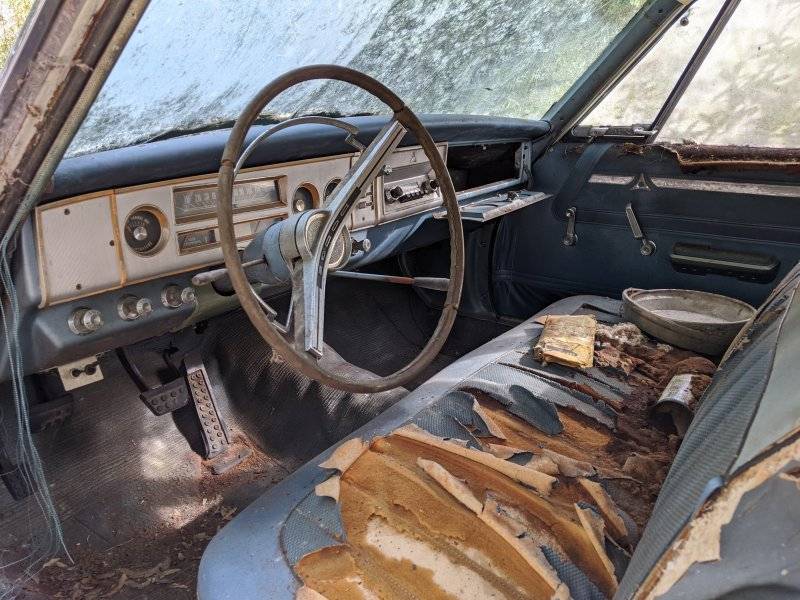

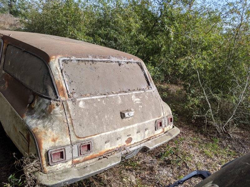

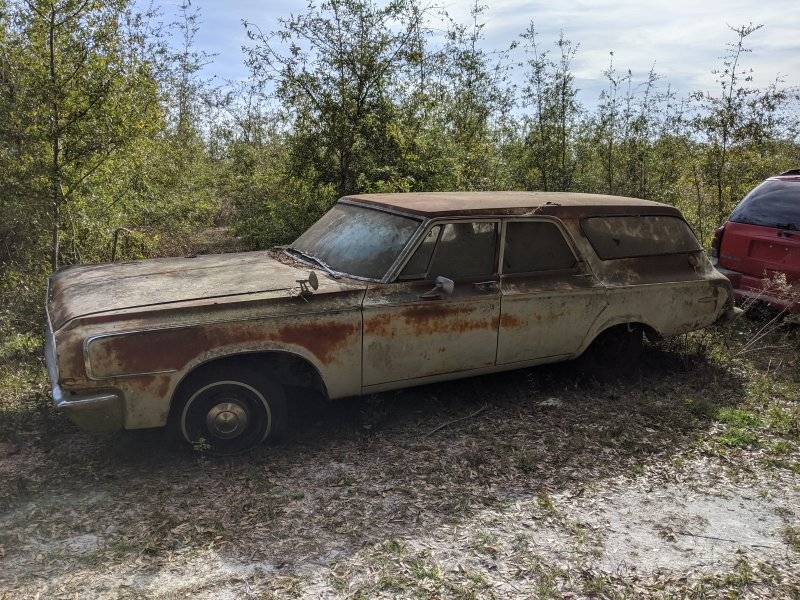

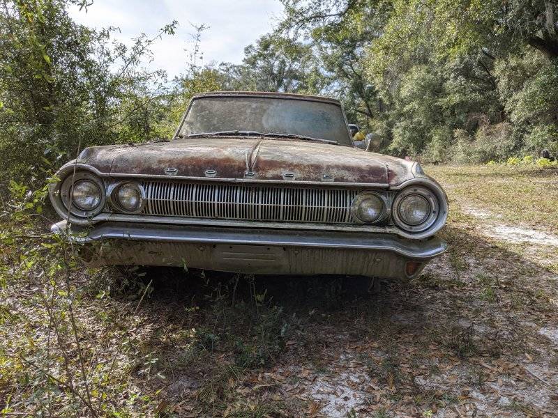

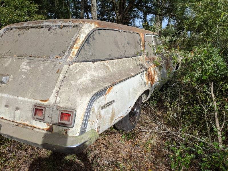

Thanks for letting me join. Was referred to this forum from Facebook. I have a Dodge 330 Wagon that I did some bartering for. It has no drive train in it currently and I would like something more modern. I would like to take this on long road trip and daily drive it. Not looking for a high horsepower build, but when I merge on to I75 in FL I don't won't to get run over! So I am open to hearing some ideas. I was thinking of a frame swap of some sort. TIA

Welcome, and that thing looks to be in really good shape... I hope you get it going one day.

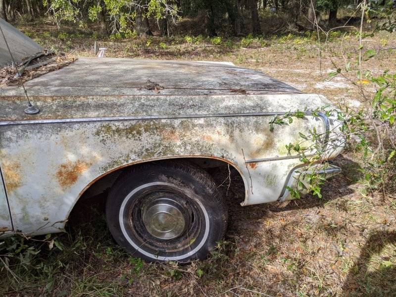

Welcome from Alabama, awesome patina and mostly surface rust.
Welcome to FBBO from Ontario. Good luck with 1964 Dodge wagon project. Since your car is a unit body (no separate frame), a frame swap is out of the question. The best you are going to do is a powertrain swap. A lot of guys are now going with late model Hemi. Thanks for your pictures.

Understand about the unibody and no frame. I would be fine with just a modern drivetrain swap then. Would I need to fab motor mounts and transmission cross memeber or is there a site I can purchase from? I am not a welder and don't pretend to be, but my buddy owns KSR Perfromance in Gainesville, FL. I have built motors and done some wrenching. As for budget, I know this will not be a couple thousand dollar project. I am thinking somewhere between $10K and $15K.
