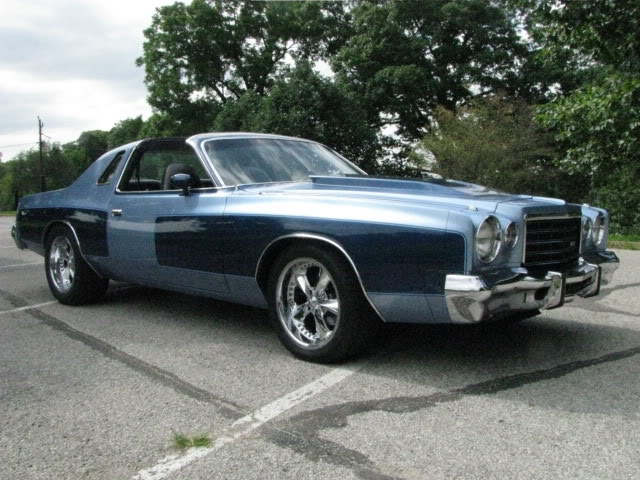

Here are some pics of it, guys. Super 77, you will probably remember them from another thread a while back in the '75-'79 section, but here they are again. Enjoy!

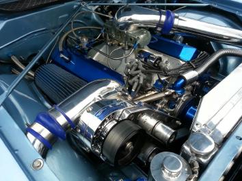

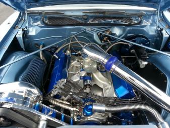

Wow, it's been forever since I've been on here! I just wanted to post an update on this thread. So after many delays and far too much back burner time, the car is back together! I have driven it a little bit when the weather allowed over the last month or so, and although I haven't completely let 'er rip, I can tell you that the new combo with the F1C blower is MUCH stronger! And with the fresh rebuild with the beefed bottom end, I know it IS much stronger where it counts. Gonna try to get some more miles on her in the next few months, and then head to the dyno for some fine tuning.
Anyway, I posted a few updated pics to show a few things I added over the last 10 months or so since I've been on here last. (Man, where did the time go?)
