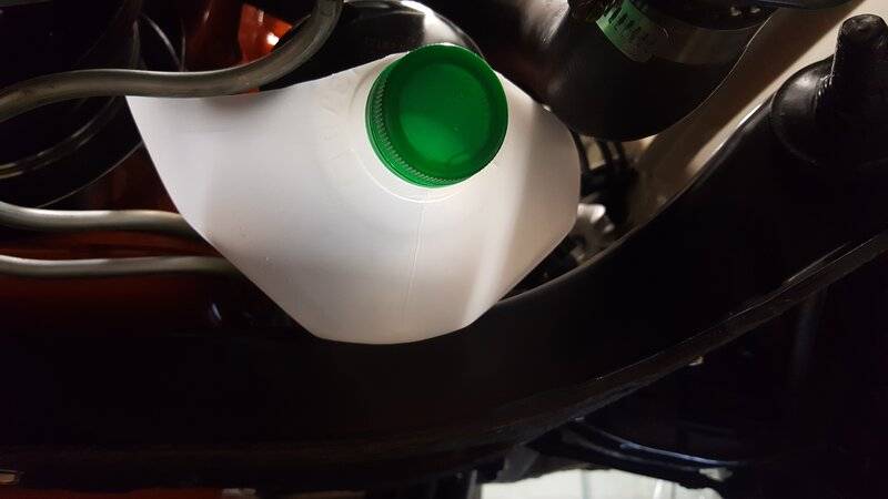

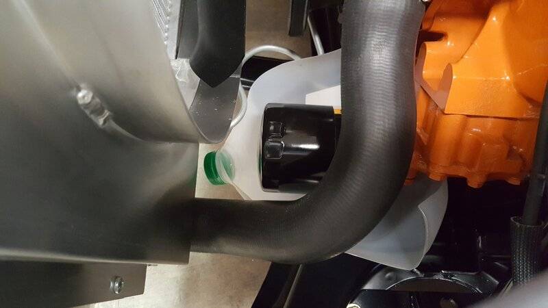

Does anybody else here do this ....
Small block doesn't have this issue.
Sure, the filter can be overfull and drain when you take it off, but it drips straight down, not on top of anything.
Both my A bodies drain all over the torsion bar. They engineers that were in charge of oil filter location needed to have coffee with the guys that were in charge of chassis and talk about this stuff.
I use a gallon jug. (Without the green cap of course)

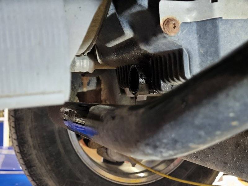

You want stupid for a drain location... here it is! Wife's Challenger.

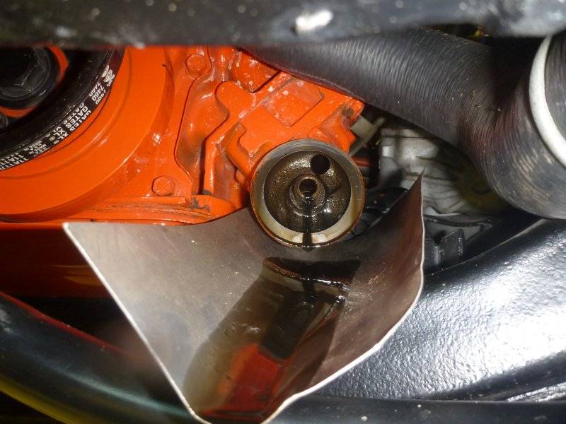

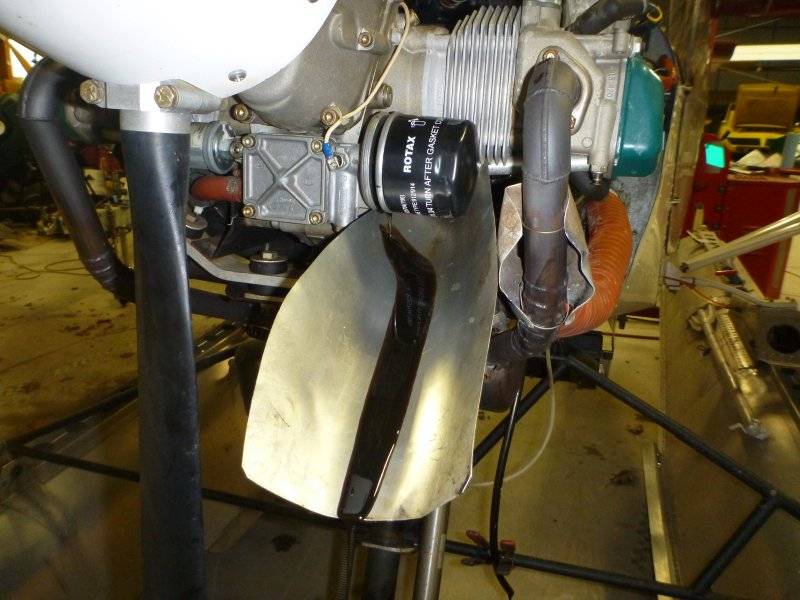

As for filter changes, I use the same piece of aluminum that I have for years whether it's the old cars or an aircraft engine..
I have something like that above ^^^ just a bent piece of aluminum
to divert it into a drain pan
Cardboard is a great idea too, in a pinch :thankyou: RC
albeit my dual remote filters on my current car
I made a different one to drain it, up on the inner fender
not much leaks if I'm careful, they are vertical

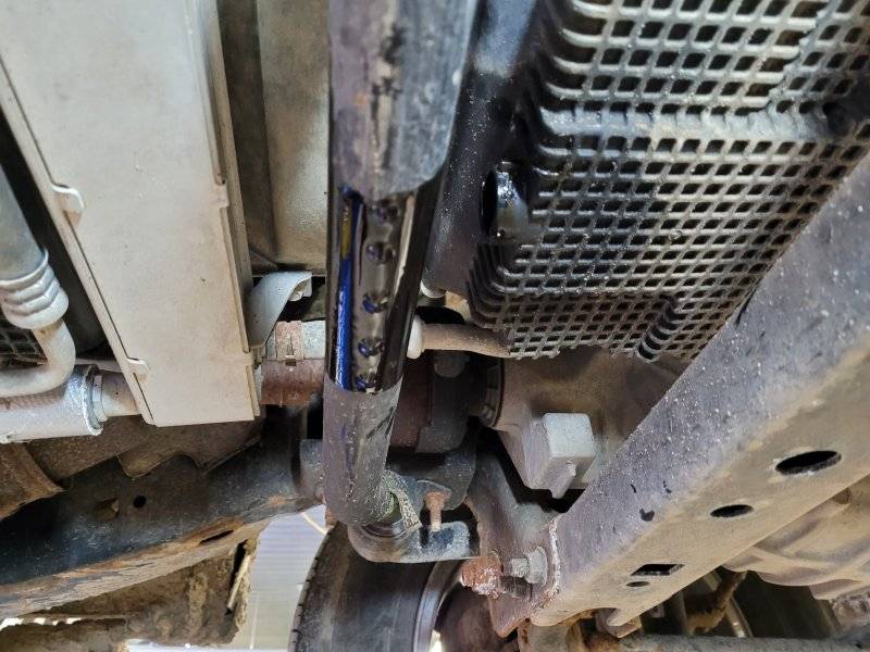

My 18 Cram "Hemi" is no better, filter dumps all over the front diff and solenoid with not much room. I hold a plastic bag in my hand to capture it. Engineers are a special lot, if you meet one though the first thing they will announce to you is "I'm an engineer" like they figure you don't want to kick them in the junk for being one.

My 2018 Ram 2500 Cummins has the filter access in the right front wheel well. I have found it is easier to just take the wheel off. The hole is just big enough for one hand and that 2 qt filter is a handful trying to get it out of there. It dumps oil all over the frame as there is no way to get anything in to catch the oil when changing the filter. What a PITA.
