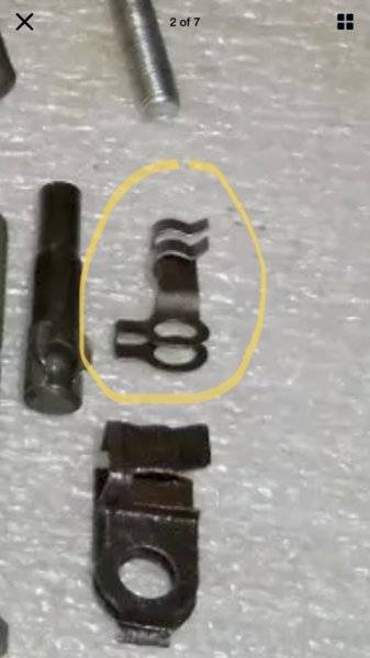

Does anyone have one of these ?

This is the clip that holds the end of the rod to the transmission lever kick down on a 904. After it’s slipped into the lever hole. It slips onto the rod and keeps it in place. I’m in the process of replacing a cable with the original linkage. Hoping someone would be so kind to help me. I don’t expect anything for free. Beyond stupid, that this rod end has no holes for a cotter pin. Like all other rod ends have.
I know where they can be found now. Disregard.
"Stupid" is a matter of opinion. There were several methods of attachment for the various linkage designs and not all of them had a hole for a cotter pin. Some had a hole for a spring clip similar to the shift levers on the 833 4 speed transmission. I'm not sure that the factory actually used cotter pins there....I suspect that cars with cotter pins may have them because someone in the past lost the original clip and used a cotter pin.

  1. I recently posted the same thing. Wondering the same thing as cotter pins are much simpler and more reliable than a cheesy clip that can and does pop off. I found these at Oreillys or Autozone in that wonderful “Help” section lol.
You could always drill a small hole for a pin. Later kick down rods got rid of those clips.

I’m aware that many of them have different end attachments etc. It still makes zero sense that all rod ends have holes for cotter pins or R clips. Except this end. You can’t say, maybe you have a mismatched part. Because all 69 - 904 Torqueflites are the same. Why put holes at every end of each rod ? But, not this one end ? You can’t say quicker attachment at that point. Because, that makes no sense either. Regardless, of the clip or not. A hole should have been machined there. like the other 2 rod ends. They used the clip on this end as if it were quicker to connect / disconnect in that location. It simply isn’t. I understand the theory of the design. But, you can remove and install an R push clip as fast and easy.

I completely agree. I understand the reasoning behind it. It’s that way on that end for supposed quick connect or disconnect. Which is not easier or faster had the manufacturer just drilled a hole for an R clip as they did on the other 2 rod ends.
I don’t have a drill press. Drilling a small hole into a 5/16” steel rod with a hand drill is not that simple. I considered tapping threads on it for a nut. Until, I found out the clip is easily available. Hopefully, my local Autozone carries the assortment package on stock. I waited nearly a month for the linkage. Had to buy another, because the linkage I originally bought a month ago is still stuck in NYC due to shipping problems there. Bought a second linkage and the seller didn’t include this clip. Unlike, his advertising that it did. Should have never sold my original linkage. No kidding, I have $330 tied up in 2 linkages. Only received one and couldn’t install the other that I did receive. It’s been a nightmare.

Autozone sells an assortment package that they call fuel injection retainers. They are also listed on Ebay as carburetor linkage retainers. Lawn tractor industry also deals with these retainers. They too are listed on Ebay as C clevis retainers. A few different names and applications for the same clips. I’m learning too, ha ha
