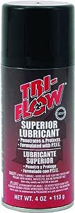

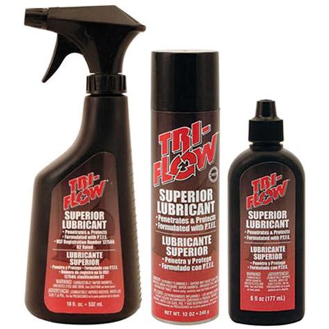

A friend just stopped by with his classic car and the door hinges were squeaking, he said he just lubed them but it didn’t work. I asked if I could spray them, Go for it! so the tri flow stopped all the squeaks, he was happy. His wife made sure to get the name of the product.

@QuickBpBp see photos for your new lube for hinges.
yes WD 40 only lasts a short time, especially outdoors.
spray lithium grease coagulates and gets hard as a rock.
I worked at a car dealership. One of the requirements was to lube the door hinges with spray white lithium grease every time the car comes in for anything. What a friggen mess. Good idea, bad execution. I went round and round with those A holes until a customer with a new car went off about the mess on his door hinges. So we got to switch away from that crap.
I will try this stuff cause exactly what you stated is why I would switch back n forth… It does stops the squeaks but not the way I wanted it to… White grease gets hard and the WD dissolves it. I only did it cause that’s is what the dealership was using when it was new and only lasts a 3-5 months.. Thanks again.

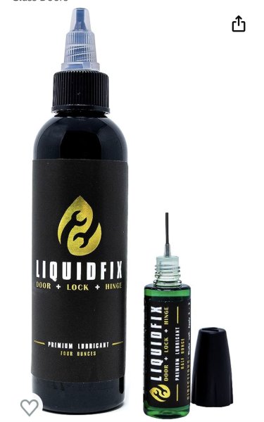

Liquidfix - 4oz dropper and 1/2oz needle applicator (refillable). $13.99
It’s thin, but has silenced every squeaky creaky. Reapply every couple months to hood hinges, door locks, deck lid hinges, the 385 lube points on the drop top. It’s frequent preventative maint., but I get eyes on things and areas that I normally would not.
LiquidFix Door, Lock, and Hinge Lubricant | 4 oz Dropper + 0.5 oz Needle Combo Pack https://a.co/d/8vtv2AU

I happened to have a can of the Tri-Flow in my garage for some other reason (I can't remember). Sprayed that on the trunk and door hinges and that seemed to do the trick. I was pretty conservative with how much I sprayed so as not to end up with a big mess.
