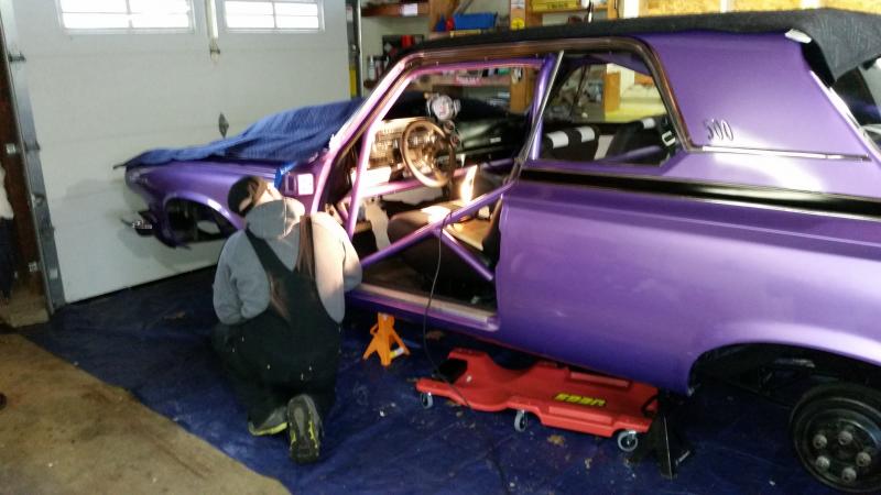

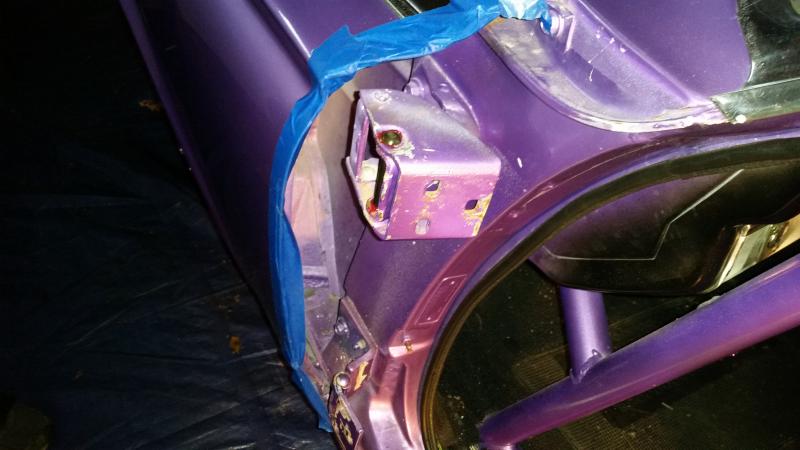

Drilled, bushed and reinstalled, happy to say no nicks the hardest part is aligning the door. My son helping out.

Thanks for the update! you're right, the hardest part is realignment. Glad you have able help! Quality time I'd say...
