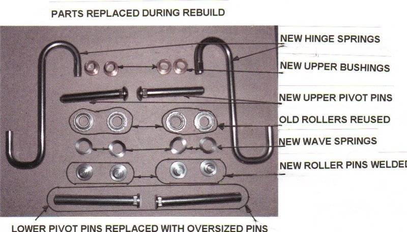

Does anyone know if there is a common part number we can buy 13/32 oversized door hinge pins locally? The hinges are for a 1969 b body.
First oversize is 3/8". We don't sell parts. We do complete rebuilds.

.406 pins are custom made for me. I use 25/64" drill bit followed by a .406 reemer. 13/32" = .406
Most hinges only need the .375 pin since the original was a .338 .
23/64" drill followed by a .375 = 3/8" reemer.
Thank You for the information. I'm not looking to send them away at this point, so I'll figure something out.
