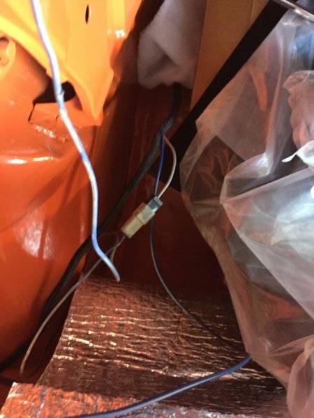

I also have this wire in the trunk . Its coming from the wiring harness that feed the tail lights . Does anyone know where it hooks into or what it's for ?
i attached photo of the wire.
Thanks
Thanks
Blue wire with the grommet goes to the fuel tank sending unit, through a hoe in the trunk floor.
