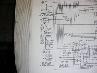

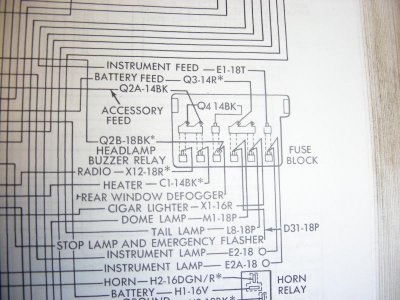

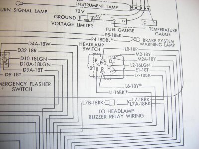

Hope this helps, one wire is to the buzzer and the other is the ground. The wires are labeled the same in the different pics so you can get an idea of where they go. DSCN8304.jpgDSCN8302.jpgDSCN8303.jpg Like I said, I really don't know allot about it as I've not gotten that far along yet, hopefully they're right about the bulb. These pics are from a 69 Dart, Charger, Coronet manual.
