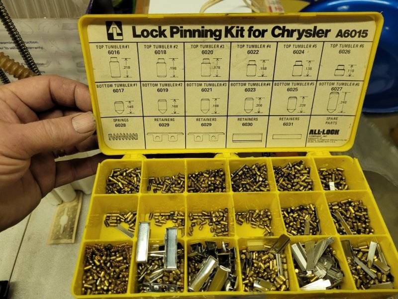

Maybe you can find a re-keying kit. @moparsaver had some and I bought one. I think I saw in another thread that he may have one left.

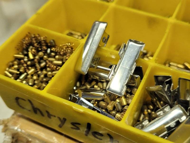

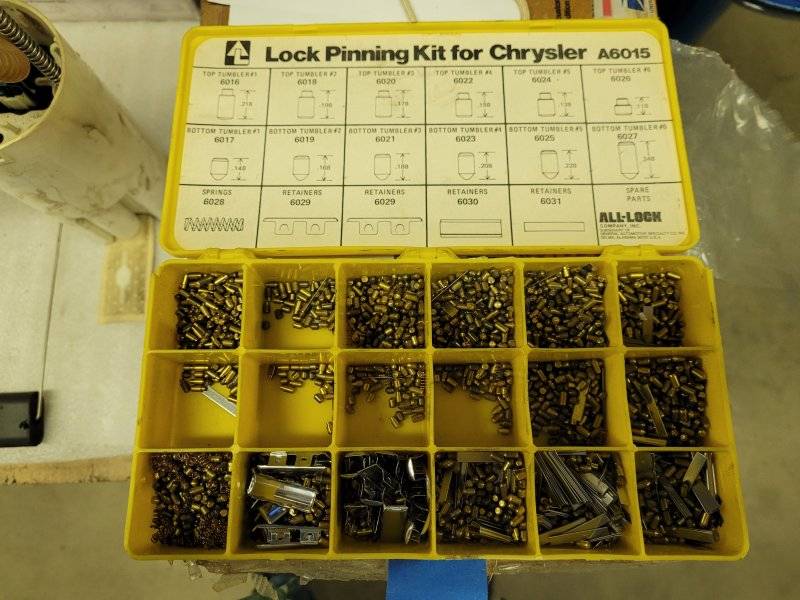

The only hard part is finding the little pins that match the valleys in your ignition key. Take a door lock cylinder and pop off that little rectangular stainless steel cover. Carefully dump out the springs and pins. I believe there are 5 springs and 10 little pins. Insert your ignition key into the door lock cylinder and then choose one of the 5 holes and insert 2 pins ( 1 blue & 1 pink from the second diagram below) and see if they line up allowing the key to turn. You can see how it all works in the second pic. When the blue and pink pins are lined up with the correct key, the cylinder will turn. The only problem is, it's highly unlikely you'll have all the right pin lengths that match all 5 valleys in your ignition key. This is where one of those rekey pin kits would come in handy or a bunch of donor lock cylinders. I have a couple door lock cylinders where i only used 3 out of the 5 pin slots because i dind't have enough matching pins.

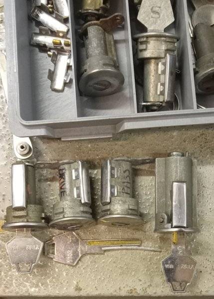

If you have enough spare door and trunk cylinders, you might not even need a pin kit.

I made most of locks on my 69 charger open with the ignition key. Even the trunk, glove box, and console. But not the gas cap. Take one apart , it's not that difficult.
