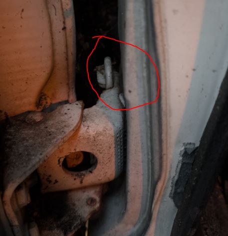

I just got my 66 Belvedere back to running. It been sitting for 23 years. My passenger side door pops every time its open or closed. The hinge is rubbing against that "bend rod". On the driver side the "bend rod" stays with in that slot unlike the passenger side. The rod does not stay in that hinge slot. I am unsure what to do to fix this issue.
lubricate the wheels, and free them up; they need to spin and ride on the bar
If the star wheel doesn't move (seized) then spray with either pb blaster, or something that will possibly unfreeze it, if it doesn't spin.
Other than that, may be necessary to replace that lower hinge with a good used, or a new one.
OK thank you. I spray some silicone lubricant last night but it didn't help. I will clean the wheels up and re-lubricant everything. I was wanted to make sure it wasn't something bend or what not.
put vice grips on them if you can, and break them free........ hit em with a hammer and chisel....... torch, whatever lol......... what ever it takes
Tri flow is a great product.
Silicone won't do it get a penetrant on it and let it soak, grasp the wheel with water pump pliers and work it loose with more penetrant on it.
Now go lube ALL your door and hood hinges on every car you own.
And don't use WD40: it's crap too.
Or we can rebuild them back to new function. Frozen door check rollers are very common.
