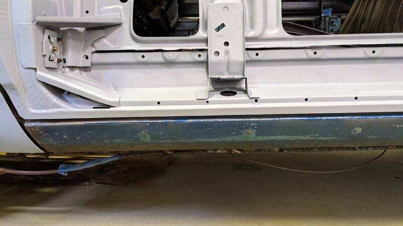

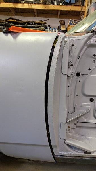

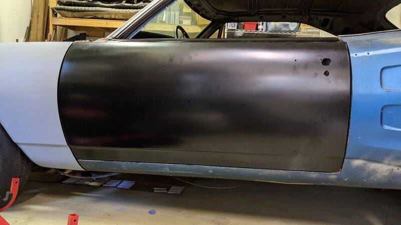

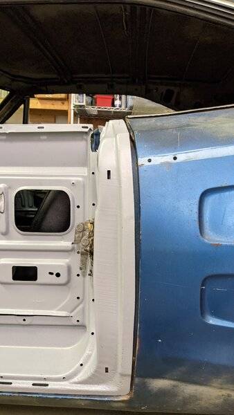

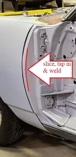

After I spent a little more time trying to decide exactly where to slice/dice, I realized where the damage had been done to the door shell and was able to pretty effectively coax it back to shape with hammer/dolly (actually proud of that, slowly learning metal bumping). Once I hung the shell again, I was pretty happy with the results.
View attachment 1171963 View attachment 1171964 View attachment 1171965

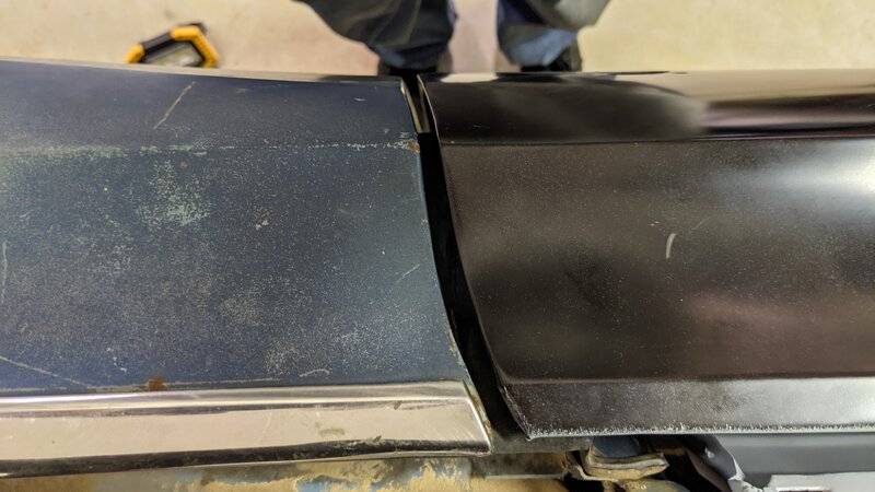

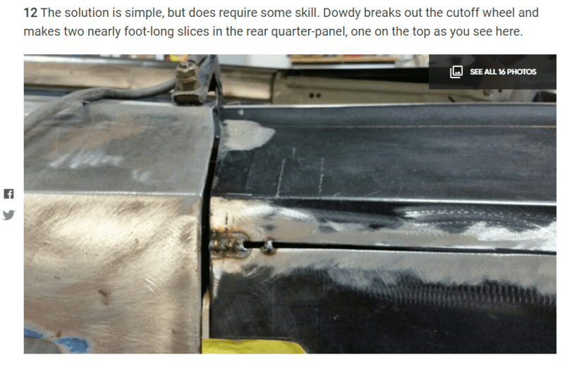

I have since put the shell on and hammered the edges (that also went surprisingly well, rubber coated dolly is a must), and have hung the door to check fit/gaps and tweak positioning before tacking it.

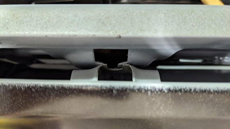

Before I tack things down though, my one concern is the alignment of the mounting tabs for the window track. I put a bolt through the hole at the front of the door to help keep things aligned, but this is how the tabs on the rear want to line up.
The door seems almost perfect in this position, if I tweak it to make these align better I feel like I'm making the door fit worse (warping it front to back). I did test fit the cap screw that goes through there to the window track, and it does have some room to move front to back, but as you can see I loose a good 1/8" of adjustability. Unfortunately I didn't get a good picture of how well they were aligned before I removed the original door. At this point there's not a lot I can do other than try to grind these out a little. Curious if anyone else has dealt with this.
