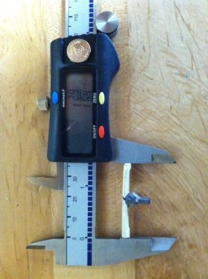

Does anyone know what to call this clip and where I can get one? Excuse the black glue on it from my attempted repair, and please note that I think this is only half of the clip...
It is the "clip" which holds the window glass into the front track on the passenger side door of my 1970 Roadrunner "post car". I'd love to buy a complete kit to replace all the fragile plastic in the door/window regulator.
I have tried a bunch of online catalogs with no luck. Anyone? Thanks in advance...

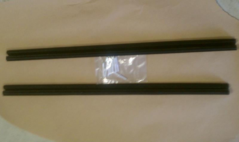

They come with the new felt guides. I got mine from Dante's. I have some used if u need but they are worn some.:
Thanks!
chry.jpgThere they are! Right on the Dante's website. I actually bought those window channel guides from Dante's, but mine didn't come with the clips and I never would have known they were supposed to. Thanks Nsane!
