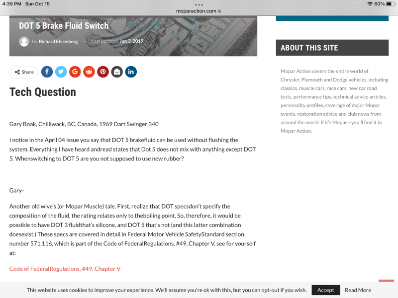

Welp, I do feel RE is a hands on tech, and I can’t argue with any tech he’s printed. I’m sure there’s variables, but seems to be quite sane, and drives his **** hard.

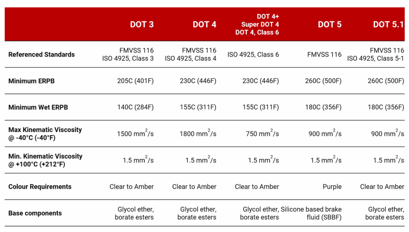

While I like RE, and have bought stuff from him in the past, in this case he is incorrect. The DOT specs do specify composition, and that's the reason why DOT 3 and 4 are clear or light amber, while DOT 5 is purple, to make sure people are aware there's a difference when they grab a bottle.

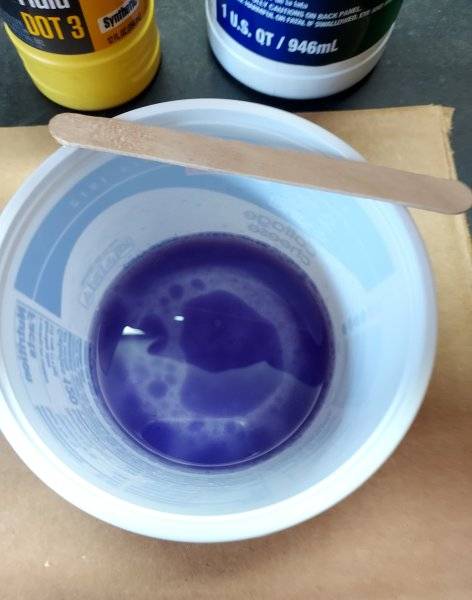

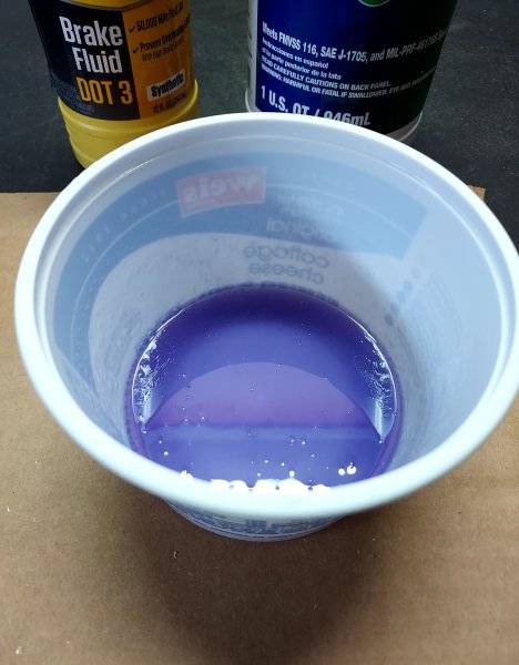

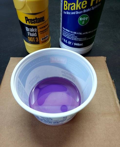

Already did this in another thread.
Mixing Dot 3 with Dot 5 it just wants to separate. If I stirred it, it would turn into a thin jell but soon after it would separate again.
Dot 3 and Dot 5 together.
After stirring
After sitting for awhile.
