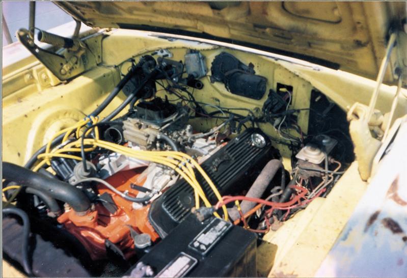

Hmm, this thread is starting to sound JUST like my 70 Bee!
At one point, it also lost the ability to start from the key.
I spent several weeks with an aligator test lead from one of the working hot wires under the hood to the dist side of the coil. To start, I jumped the solenoid with a screwdriver, and to stop, I unclipped the test lead.
Made for an interesting show and conversation starter.
That car got nicknamed the Millenium Falcon due to the fact that it could make the kessel run in under a given number of parsecs, but always seemed to have minor system failures that could usually be rigged with a temporary work-around, while uttering the phrase "come on baby...hold together".
Finally discovered the main hot through the bulkhead connector was corroded inside the insulation. Note the temporary fix in this pic, after I found the problem.
