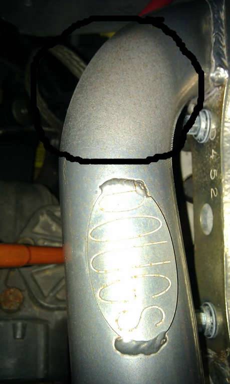

I have the Doug's 452 Ceramic Coated headers. I have had them for just over a year now. They are starting to rust. They have no street miles on them and only 6 passes at the track. The headers have never been wet. I even wiped them down after the install so no marks/finger prints were on them during the start up. Needless to say I am not happy with this. These are not the most expensive headers on the planet but they weren't cheap either.

Are yours rusting right up by the top flanges where there is the most heat?
pics would be great. i probably know the answe after you post the pics. you might not like what i have to say though.
LOL.........nice "you're probably gonna be pissed" legal disclaimer Chris..
Mine are starting to rust too, very, very light. Mine are about a year old too. Just little specks.

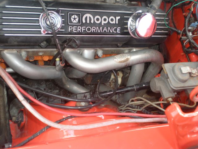

This isn't to only spot this is happening. Down on the collectors,downtubes and other tubes. As you can see the rust is on the whole tube just worse in this spot.
well, it is poor quality ceramic coating. if it was just on top, i'd say you were running lean. seen it many times running a lean condition and discoloring the header tubes. those are just poor quality and a cheap quick coating. you'd never see that when doug;s was running that company.

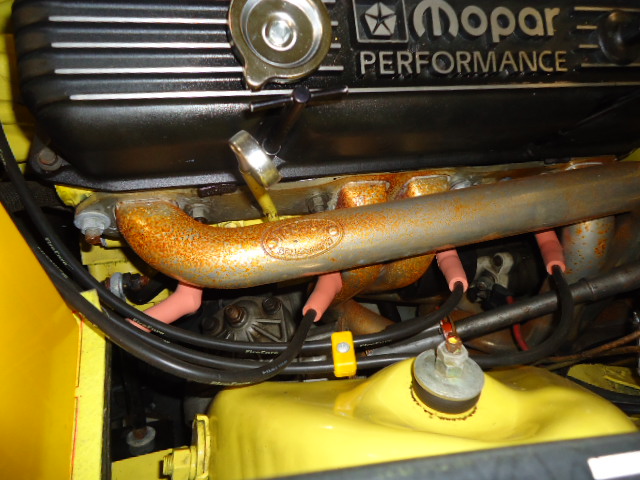

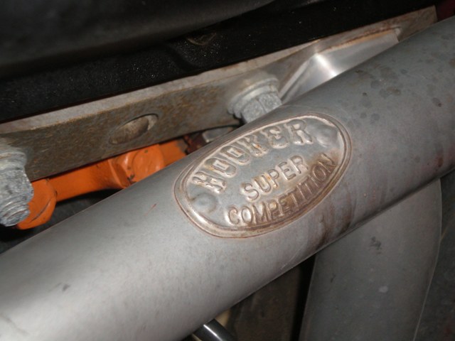

My ceramic coat Hookers are five years old but don't have a lot of use on them. Anybody know how to clean them up??? I paid extra just so this wouldn't happen.
Some years ago, I sent a set of new headers to JetHot for ceramic coating (this was before you could buy them already coated)... not too long after , they looked exactly like yours ! Don't know if they're still in business, but that was the last time they got mine. Garbage.

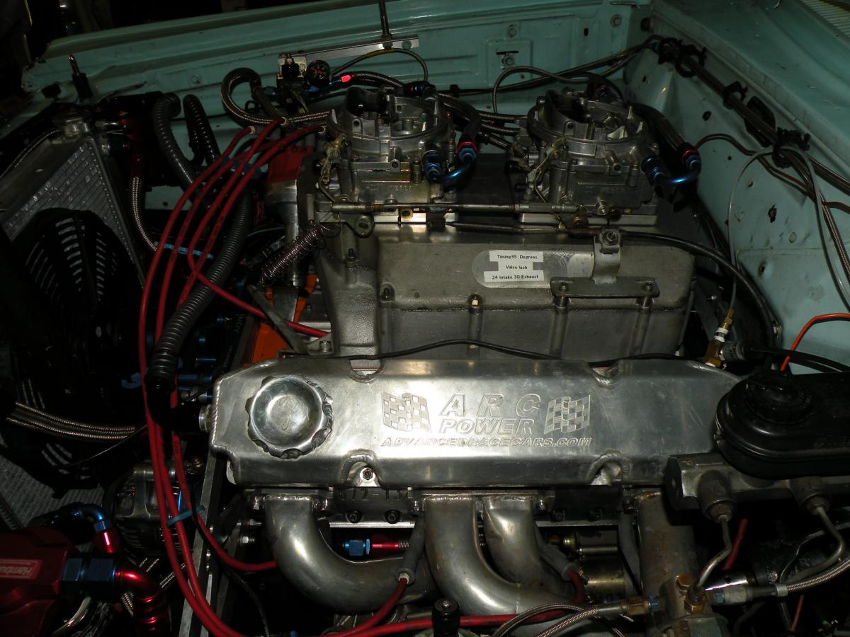

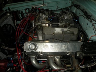

i use airborne coatings out of hartford, connecticut. best around. mine are 4 years old now.
Jethot is horrible imo.these are jethots crap. coming off over the winter and getting redone.

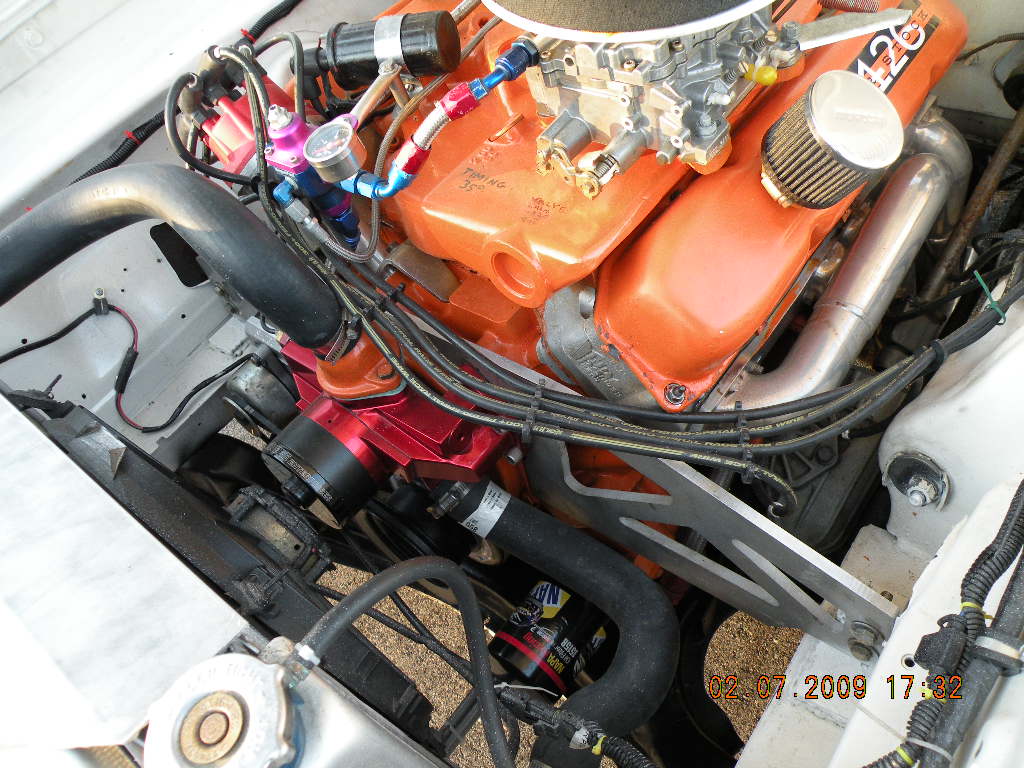

these are airborne. look at the difference. 6 years old.

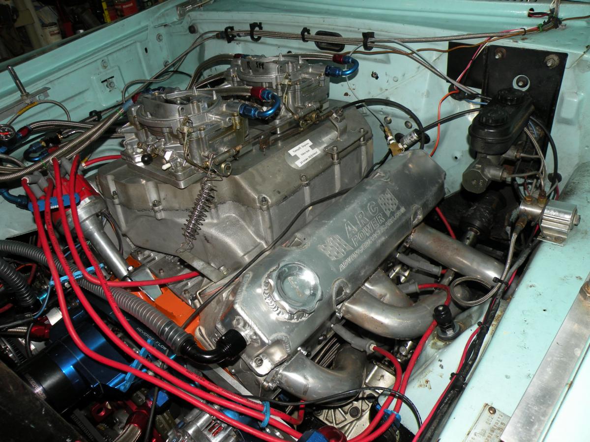

my jet hott headers still look pretty good up top after 12 years but down by the collector they are all rusty and peeling
all the spots are just oil
