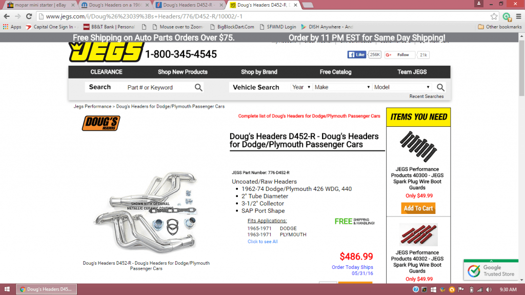

Cheaper at Jegs, I was about to buy some hookers but these are $100 cheaper

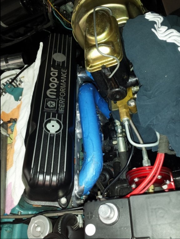

Mine were ceramic coated and my Coronet has power steering. I just blue taped the heck out of them. Probably too much. lol Your welcome.
