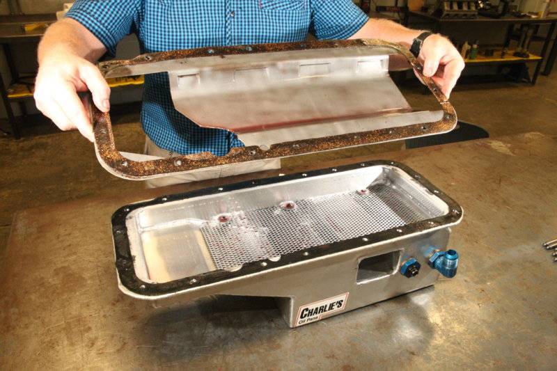

ready to install new motor in my 1963 plymouth , currently a 68 440 block no girdle with appx 1/4" clearance between drag link and charlie's oil pan thru oil pan hole..New motor with girdle will drop it down appx 3/8 inch..no good.
what have u guys done ? mill the drag link .250 on top ? install a differant drag link with a differant offset ? aluminum oil pan..thanks. picture is for referance only but its still the same.

easier to get a pan made, or modify that one.
motor plate is already welded in where as i'm just swapping in new engine and the new heads already raise the intake a 1/2".. so its either modify the pan tunnel or like someone else has done, mill .250 off the top of the drag link ... mostly street driven car..if i do that i would be inclined to weld a V shaped stiffener to the bottom side of it...was wondering who else mite have done any of this...

the drag link is in correctly, u shape facing down and forward..removing headers today to get a more presice measurement on the clearance it has now with No girdle,,With a pan gasket installed now, it looks like its slightly more than .250..so if i install the pan with No gasket, just silicone it mite clear..maybe run a grinder across the top drag link removing minimal material to be sure ? i thought about raising the rear transmission mount also,,,but to correct any pinion angle wouldnt that require cutting off the rearend pads again ? thanks.

up date,,headers r now removed for engine extraction tomorrow morning,,with them out of the way was able to mic it,,.490 clearance between drag link and top of pan tunnel with pan installed with a gasket on old motor,,:thumbsup: ,,so as far as the new motor setup leaves enough room for the hughes .250 girdle (which is siliconed directly to the block,no gasket) and probably my cometic pan gasket which is very thin, rubber type coated steel. Or no gasket also just silicone ? being its coated steel i dont think it would be any easier to remove than no gasket........... thanks.

if i shim the rear of transmission in the cup holder it will raise it up...which is what would need to happen..but i think i am o.k.,,,i think i need to find a paper thin gasket though if i ever want to remove the pan again.cometic says no sealer needed, am i gun shy on this 1 ?

did that,,when it turns left and right the drag link goes lower thru-out the turning radious...its at its highest when centered...thanks.
I've used Ultra grey on pans with no gasket. Seals fine but tough to get apart later.
