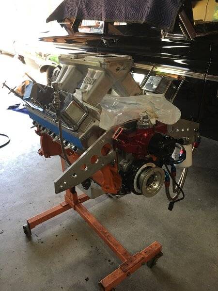

when i took the pan off yesterday , it came off pretty easy and i had used ultra black with a cometic steel core gasket. no windage tray because its built into the pan....after doing some reading on the engine masters channel they say when using a gasket, not to use silicone on it, use a gasket sealant instead...dont know which way i'm going to go yet but, i will be adding a dip stick to the pan,,it doesn't have the kick out like some do so i'm going to add a side mount housing like some fords and chevys have,

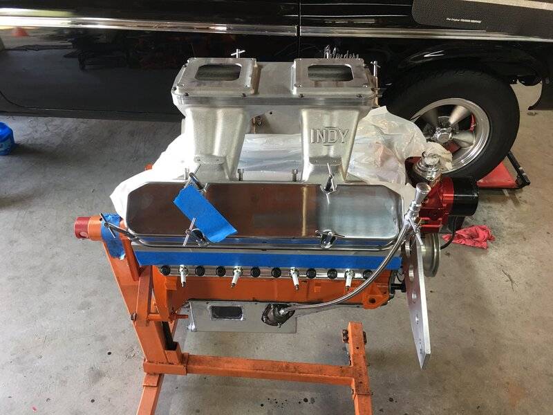

added a dip stick set up to this pan today..housing is from a 79 ford. heavy cast iron So with a gasket and sealer should not leak ...calibrated it with water at 6, 7, and 8 qt increments. i need to find the best long term flexible sealer there is.
Looks good. I use Ultra Grey on my stuff. Never leaks. If its a big surface like a valley plate it will be difficult to take apart.

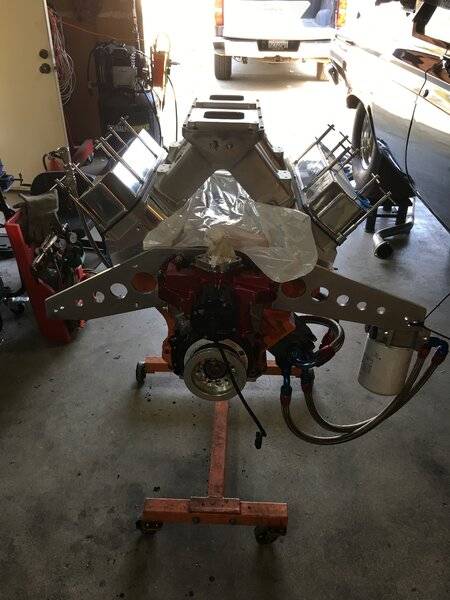

new bullet is almost ready to go, dip stick housing doesn't leak but 5 bolts leaked some oil with the new girdle in place. pulled them out and pumped "the right stuff" into the holes and brake clean and coated all the washers, bolts, etc..will spin up the oil pump later this week and set oil pressure. if anybodys in need of a 440 max wedge dick landy style long block..........
Charlie’s didn’t do a very good job on the drag link hole. I had to open up the top passenger side of my pan to fit my dart as the bend in the drag link hit it. Everywhere else it was close on the bottom. I think the ones with the holes work better.I just had to add a spacer to mine dolce to dropping the k frame for header clearance.
