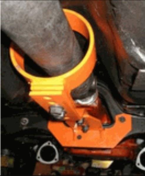

I have the Mancini bolt in driveshaft safety loop.

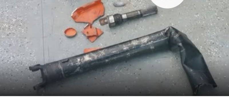

Wow! I just watched the video, and he had a safety loop!
Now he has FIVE driveshaft safety loops, and made the new transmission tunnel out of steel plate! His arm was tore up from the floor up! 8 surgeries and enough hardware to open a True Value!

As for the driveshaft in that camaro, a loop is intended to keep the shaft off the strip if the front u-joint breaks. It oviously wont contain a shaft the gets twisted into pieces. If the drivetrain locks up, as stated in the video all kinds of busted parts will be going everywhere!
They stated that the trans locked up. I wonder if the transbrake engaged down track, or if maybe he got first instead of neutral trying to shut it off and get a plug reading? I'm surprised the trans didn't come through the floor too!

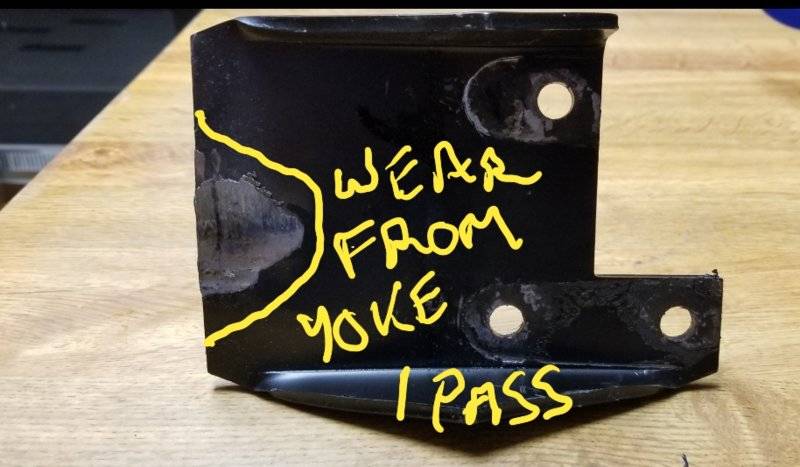

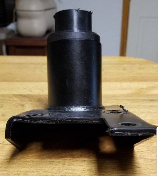

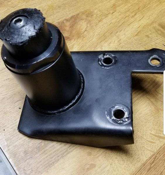

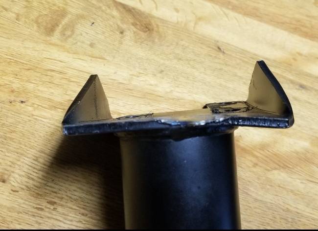

It has been great so far. I am going Calverts and mono leafs this year as I was having issues with wheel hop even with the pinion snubber tight against the floor. I bent the pinion snubber where it was rubbing on the pinion yoke.

Me too! First run, I noticed a slight scraping sound after the run, and had lots of wheelspin.
2nd run, it was so bad I didn't stay in it, jacked the car up in the pits, and I had to remove the snubber so I could drive it back home. See pix:
I sent Mancini those same pix at their request and told them that was 1 full out run, and one launch and aborted 2nd run.
After that email, I heard NOTHING from Mancini. No "It's not our fault" or "Your springs are shot" or "We don't like to talk to people, we only sell stuff, and F off"...
Nothing!
View attachment 895860 View attachment 895861 View attachment 895862 View attachment 895863
Nothing!
Yes mine was an old NOS Direct Connection one that I had. My car also had newer HD rear springs that were made for the previous owner (not cheap) and I put a bend in the main leafs
That's interesting. I had a homemade (not by me) adjustable snubber on my 62 (braced a LOT stronger than that mancini!) with the stock springs, using four homemade (this time by me!) spring clamps on the front of each spring. Video showed that even with the snubber against the floor, it wasn't doing anything. With the setup I had then , the body lifted so much, the shocks topped out ,causing spin. There was at least five inches of rear lift, probably could have thrown a chicken between the floor and the snubber.
New super stock springs solved the lift and the shock problem. Body lift is now two to three inches, depending on launch rpm.
