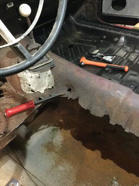

Riddle me this? As I replace the floorboards in my 68 Superbee....I am puzzled by something, and need some advice. The driveshaft tunnel, on the driver side, just behind the shifter tunnel has a small indent, like the size of a baseball. The replacement panel (AMD) doesn’t have that shape. There is a hole in the indent, mostly rust, so hard to tell if originally there was anything there. Anyone know why this shape / indent is there? Not anything to do with shifter / linkage, since everything is coming thru the shifting tunnel..... I’m ready to patch over it......or do I dare not??
Ok then! Thank you Beekeeper! It is such a smooth impression, I wasn’t sure if it was supposed to be there or not. Haven’t fitted that side floor pan yet (waiting on the new shifter tunnel) so hopefully the pan will cover and then will simply cut out. If not, cutting and patching will have to do. Thanks again!
I know exactly why that's there - the patch on the tunnel is the clue. At some point somebody installed a Hurst Ram Rod or Super Shifter. An arm moves the shifter up and back and that patch is where the longer shift arms would pass through the tunnel. The "dent" is for clearance for the reverse adjuster bolt.
Hmmmm, I wouldn’t have ever thought that. The patch on the shifter tunnel matches the several patches that were basically....the floor.....before I tore them up to install the new floor pans. So if I keep what is in there now, shifter wise, I shouldn’t need that. Guess I will wait until the new pan is in before I decide to patch and keep, or patch and cover....all great info! Thanks!!
