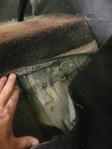

Just looked at my race car which I made a mock floor for years ago. Yeah it's pretty up there. I agree with the self tapper type bolt idea

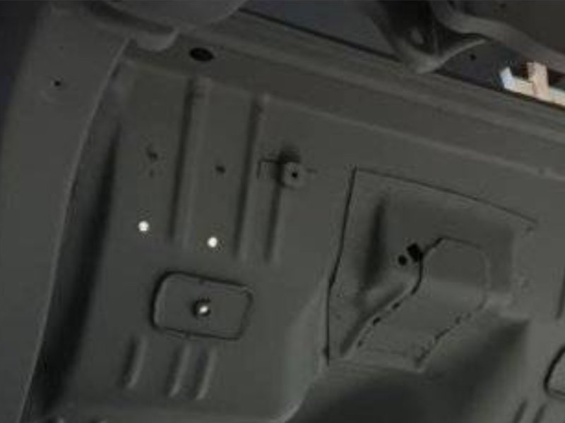

This photo is a 1969 b body, should be the same thing. Dimples are from the inside out.
Cool. Photos have been very helpful. I have the bracket showing in the mail today. Exhaust is all laid out and loosely clamped to stay in place. Hopefully get it in and tightened up in the next couple days. This was the last piece to get reassembled after pulling my transmission for an at home rebuild. So hopefully be able to test drive how we did this weekend. Fingers crossed it shifts like it should and I don’t have to listen to the exhaust hitting my shocks over bumps when I have the kids in the back seat.Thanks again everyone!
