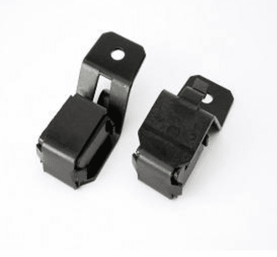

Ran into a minor issue recently with tail pipe hangars that bugs me. The hangars that came with the full header back kit for a 68 Road Runner included the tail pipe hangars as shown below.
Correct me if I'm wrong guys but these are Charger hangers, right?

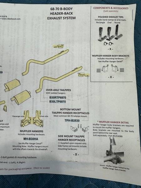

Their diagram shows the following. Their default hangars are described as "Most common 68-70 tailpipe mount". I suppose they are for a Charger. They list another side mount "On Request" that looks more like an A body tail pipe mount to me.

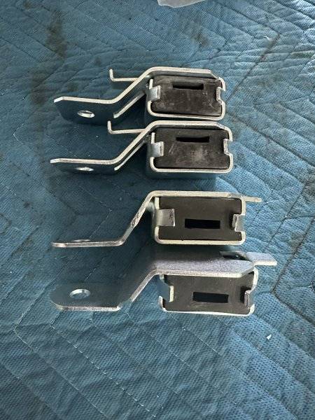

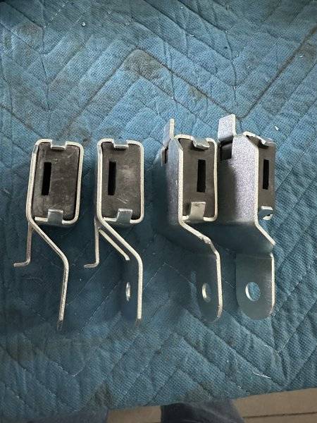

The correct hangers showed up today. See below.
Correct typical B Body on the left / top. Charger only on the right / bottom.

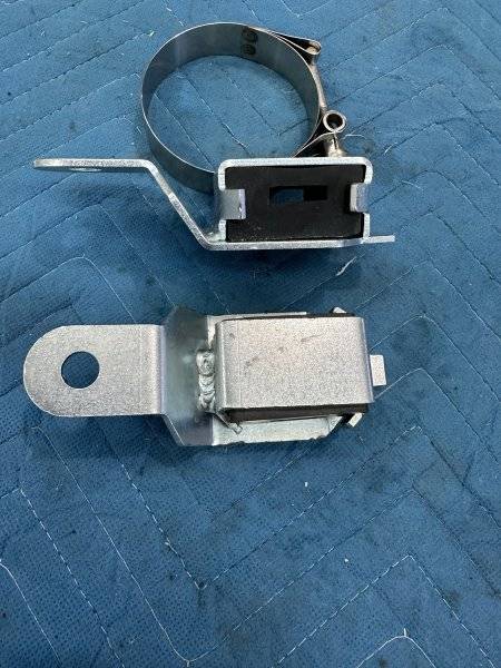

My guess is that TTi figured they could add the weld between the bolt tab and the block (3rd hangar in the second pic below) to give it a little more rigidity. That way they only have to stock one hangar. Again just guessing. Still probably not as sturdy as the correct design.
