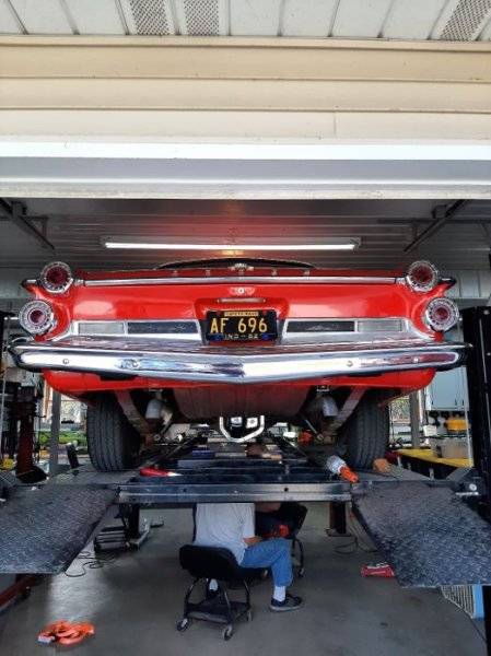

I'm having a MIGRAINE trying to fit a TTI Exhaust system on my 62 Polara 500 2 door. I gave them both HP manifold numbers for the supposedly "correct" down pipes and per the destructions, to begin assembly from the rear. We mocked them up anyway just to see and BOY what DO we see? The drivers down pipe seems not to be bent correctly as it takes the drivers side half of the "H" pipe WAY over towards the drive shaft. Also, both halves of the "H" pipes are way too long to even fit into both mufflers and I DO have the correct Dynomax mufflers as recommended. I called them and the TECH guy (very cool dude) said to put the drivers side "H" pipe onto the drivers side down pipe and BEND the down pipe outwards towards the drivers door. We were thinking if we DO that, then the "H" pipe halves will NOT fit up and connect together. I've searched for comments and videos and found only TWO videos that were "out there" and not related to my issue. I have not bent anything as of yet. TTI confirmed my HP exhaust numbers and I "supposedly" have the correct stamped down pipe part numbers. I'm thinking the down pipe was not bent correctly? Any comments or remedies to this issue will be greatly appreciated!

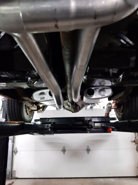

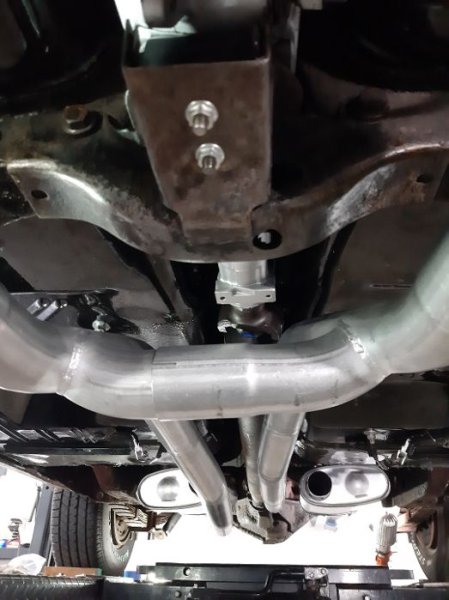

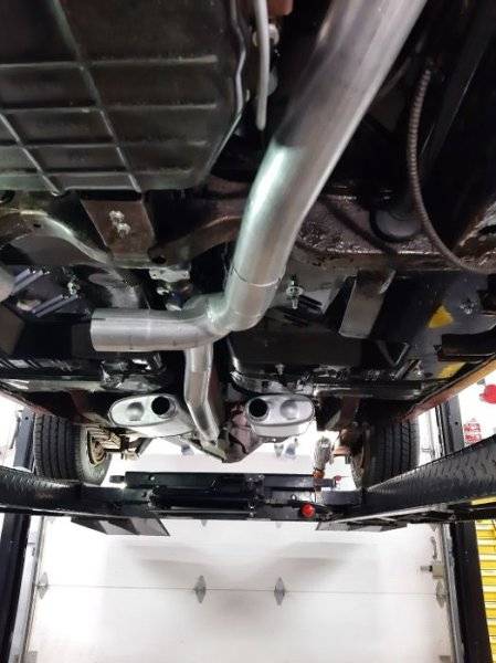

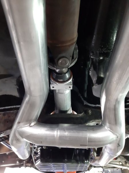

OOOOOOOOOOO K! After FURTHER REVIEW, "4mulas" posted that he had the same issue and they sent him another down pipe and it was still off, so with that in consideration, we determined it was actually the DRIVERS side of the "H" pipe that was not bent correctly that was causing the offset problem? It also could have been a very minor problem with the down pipe but we were not sure. Soooooooooo, we assembled two ratchet straps, one just behind the "H" pipe and one on the furthermost end of the "H" pipe by the muffler. We counter strapped the "H" pipe to the passenger's side of the lift ramp to AVOID any extreme pressure to not crack the HP manifold and then ratchet strapped the end of the "H" pipe to the driver's side of the lift ramp and went at it. Of course we had to "over ratchet strap" the pipe so it would eventually "relax" back to where we wanted it. This procedure was a perfect remedy for the fitment problem. After it was all assembled, it looked "tits" ! As for TTI, I would buy from them again since the quality of their pipes are way better than a muffler shop along with the tail pipe bends that are a historical Mopar trademark coming out of the back end. I am going to call their tech guy and have him research the drivers side "H" pipe geometry if they are getting calls from the 62-65 guys like us. THANKS to everyone for their input ! As for the Dynomax Turbo Mufflers....oh YEA!

After it was all corrected, I believe the TTI pipe quality is way superior to the local muffler shop after looking at them.

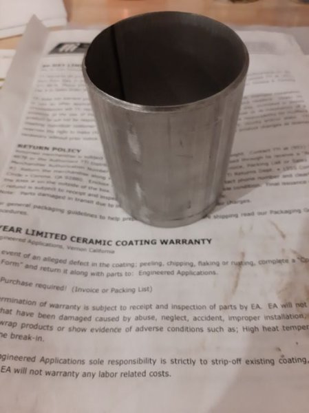

Oh yea, (2) other things to mention: We had to cut 3" of the "H" pipes to fit into the mufflers (which is common) no biggies there, (the last 2 pics) and since I decided to leave the (frozen) heat riser on the passenger manifold alone which was stuck in the open position and not grind the flap off or replace it, THAT came back to bite me in the azz because we could not install the down pipe to the manifold because that open flap gave us no clearance so we had to unseat the pitman arm and drop the control arm and THEN it fit right in. Zzzzzzzzz.........
Sounds like you got it all right the original H pipe on My 67 R/T only had a little more room than the tailshaft housing needed to hang it on there when you were stabbing the trans.
I trial fit everything on the ground and measure the spread before trying them just a very small rotation can make a big difference in the end position of the pipes.

Good job and thanks for the pics they will help people out when they build their own or adjust the ready fits.
