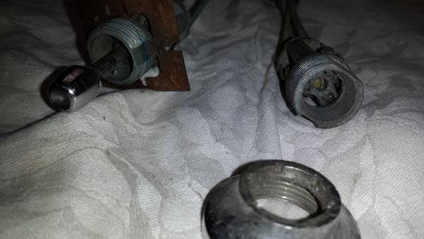

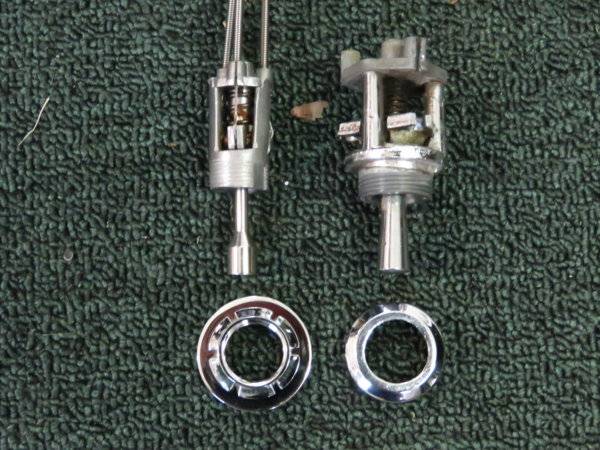

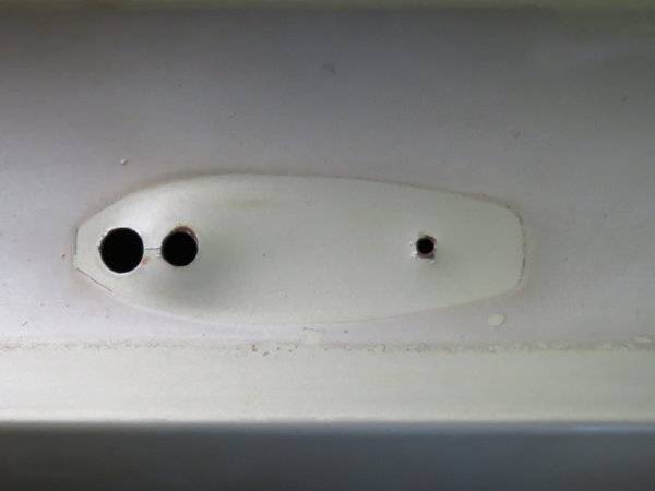

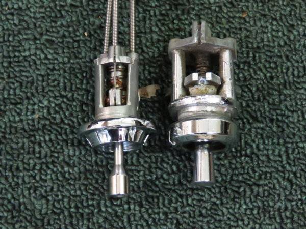

The reproduction remote mirror knob is on the left -- the original 66 Charger is on the right. The thread diameter on repro bezel is smaller than the original. The biggest problem -- look at the three holes in the door panel. The right hole is for a mounting screw, the center hole is for the stud that goes through the door (a nut is affixed to the other side), and the hole to the left is for the original cable to pass through. The original remote handle could be disassembled which allows you to pass the cable through. It doesn't look like the repro can be disassembled. I hate to drill a large diameter hole behind the center hole to allow the repro knob to pass though. Any experience on this or ideas?

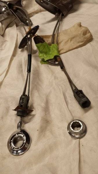

Can you transplant your OEM cables and actuator to the shiny new mirror and housing?

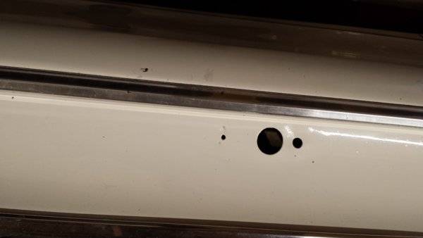

Do you need a picture of a later door?
Yes, that would be great!
That would be great --- but I can't see how the new actuator can be disassembled and how to modify the tips of the cables to fit the old actuator.
Junk yard later A body pull and the original 67 missing the little stem.

That center hole is either 3/4 or 7/8 where the mirror mounts and it needs to be there. I used an original "clip" that holds the adjuster inside the door face and a rechromed bezel and then the inside two mount holes can be correct. I ordered the two knockout punches on EBay for about $10 each for mine and one size fits the inside and the other fits the outside. This is on a 69 and I believe they are the same.
