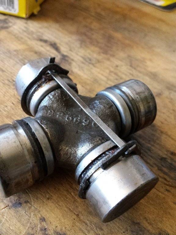

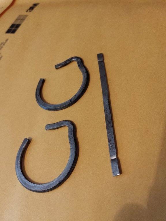

Close....I need two sets for two cars...the strap is 1/4 wide with a bend on each end and has two special c clips with a notch and the strap slides through to hold the cups in place.
Nos u joints do not come with them. It was a factory line piece only. The strap can be easily made but the cup notch clips are a different story....

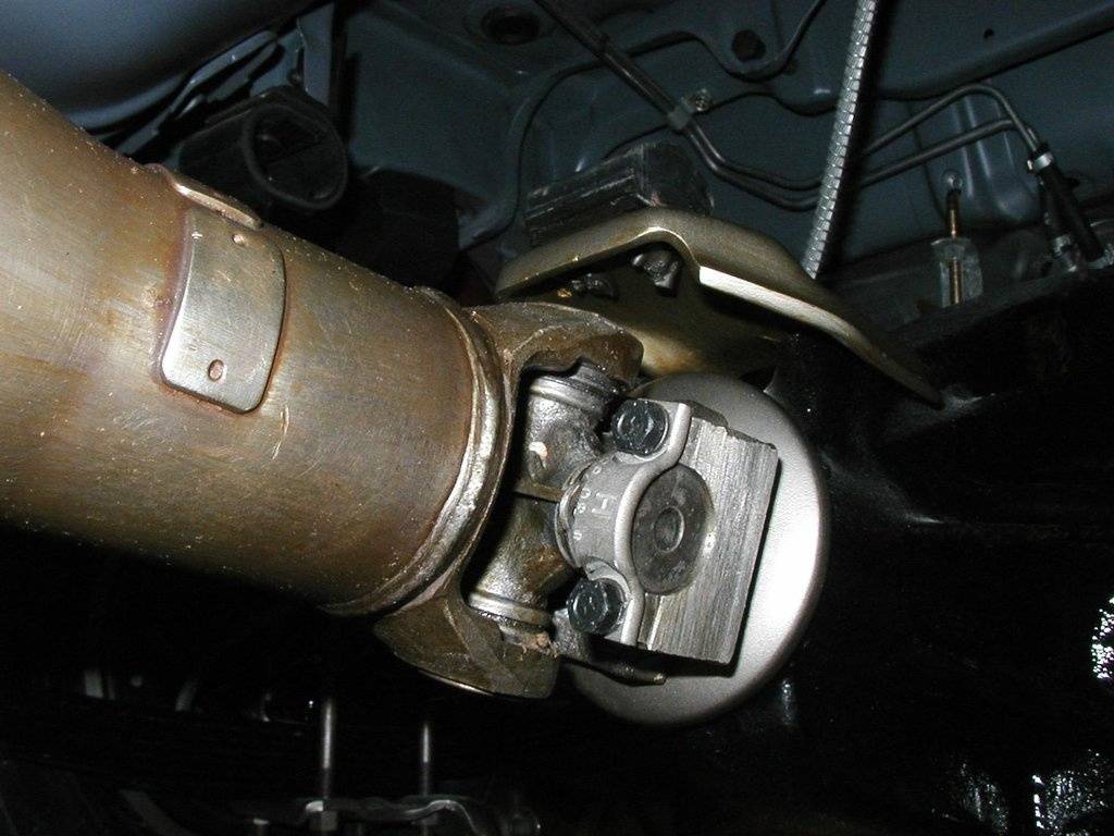

napa's find o' really okay autozone well . my first stop would have been a driveline shop , they could tell you whats what with your line . sounds like someone put a small yoke r/e in your car , modified the d/l to match . i would have put a wrenched u joint in it , that accommodates both u joint sizes of the cross .
When I saw them it was at least 30 years ago. Didn't pay much attention to them. All I remember is strap with the clip. You must be trying for a 100 point restoration.

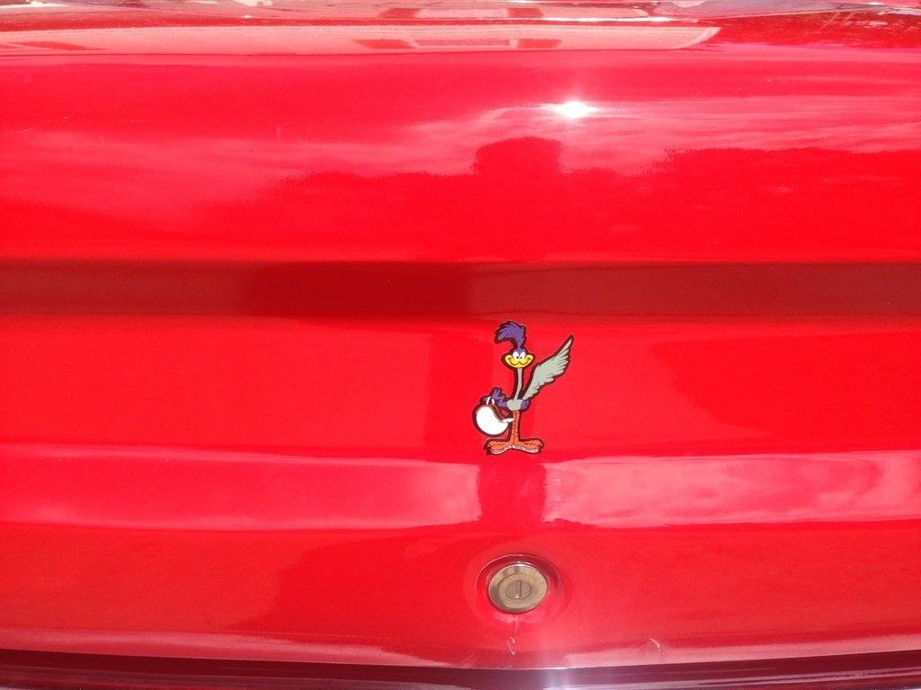

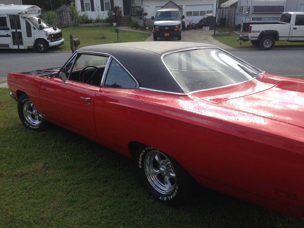

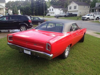

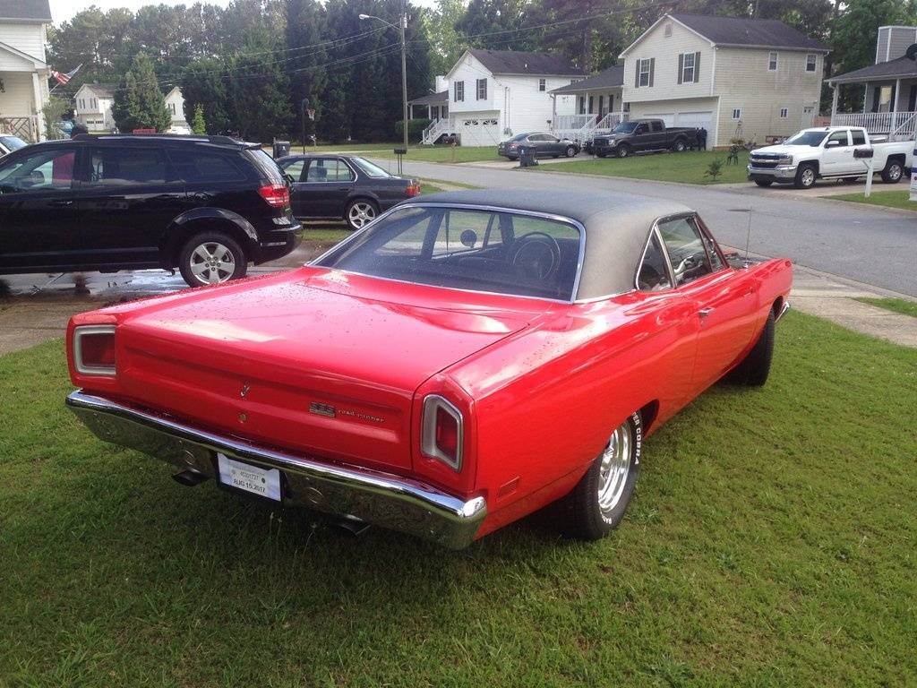

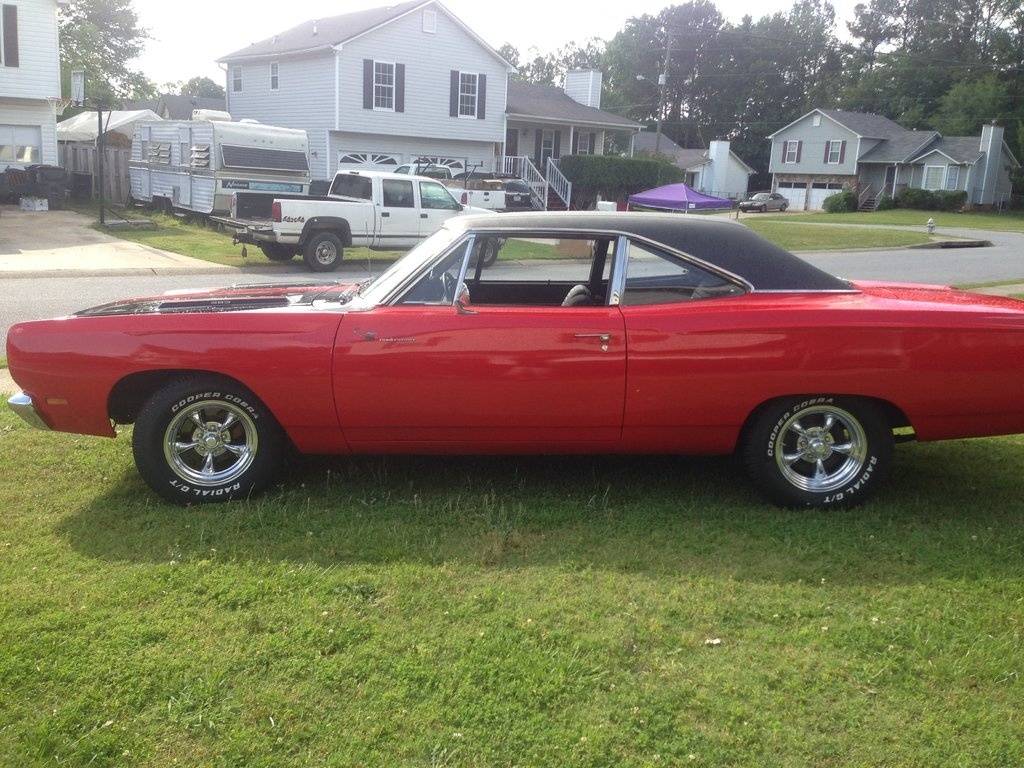

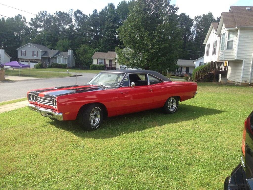

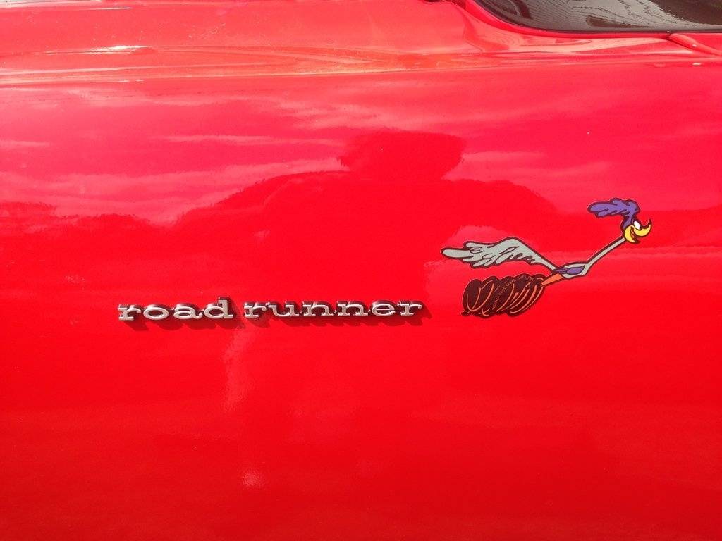

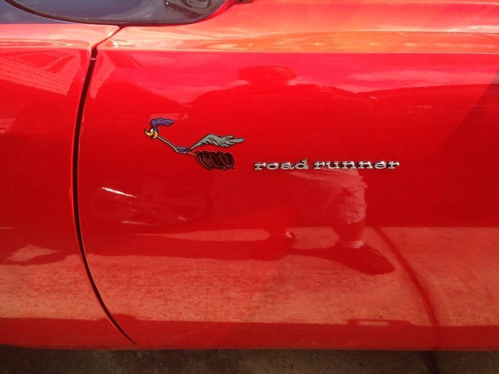

OK guys thanks for the info and helping me with part numbers. The 1330X did the trick for the front ujoint. And the rear I had to modify the clamps a little to get them to close down on the 315G but its good now. Changing that to a 3.23 rearend made a hella difference in the way it felt on the road. I mean it was running @55mph 4500 rpm ALA the old tach. Don't know the true rpms but you can tell when its revving higher than it supposed to.
Also installed the decal set today.. I think I am officially done with the RR until I tackle the steering gear. And shocks.
Hope the placement is correct. I'm pretty sure I have them well placed.

I wish when you saw them you kept them lol......One service and the trash can they went or the originals rusted away. Not trying bro thats the way I tackle them, it is the type of restos I enjoy to do. Keep an eye out if you find even one set I would compensate very well...Below is a pic
I have one used set you can have if you want it. I doubt I'll ever do anything with them. These are off a 7260 u joint sio they may be too small.
