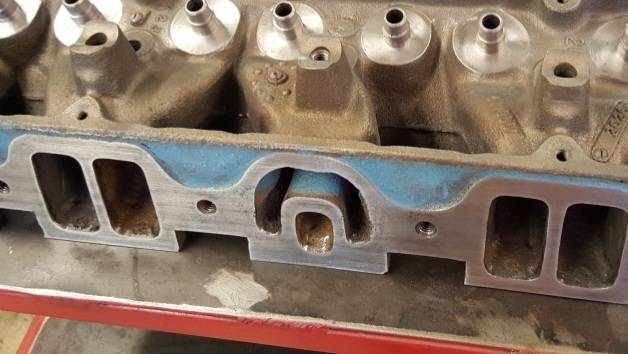

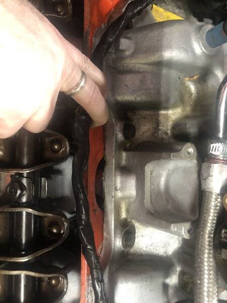

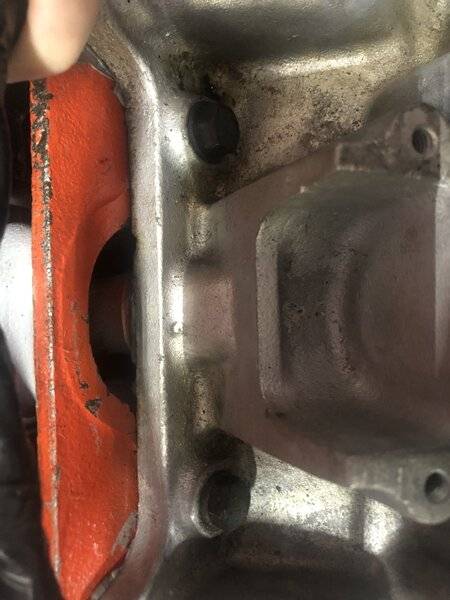

How do I get it out? I have a performance 440 intake manifold that has these great air gaps. I’m an idiot and dropped a bale cover bolt down into one. Any ideas on what I need to remove to get it?

A magnet. But I don’t think that drops into the bottom end. One of those telescoping magnets will get it. You may have to bend it to work.
Like 440 said, find a small diameter telescoping magnet. That hole doesn't go anywhere if you can't get it.
Some screwdriver tips are magnetic. Test on another bolt on the workbench. Place a rag next to the valve springs to cover the pushrod holes so you don't drop it down there when you get it out.
Happy Fishing!
Fold a paper towel sorta in a shape to go into the crevice. Spread Indian Head on the front surface. Let it get tacky. Slowly push the paper towel in, slowly pull out. ( As one may surmise, something yours truly experienced ).
As Stanton mentioned, it won't hurt anything if you can't get it out..
Shop vac and a stiff wire with a small hook on the end has worked for me.
It just fell in there, it wasn’t pounded in there. Now it will come out easily with a small magnet on a stick.
You aren’t the first or last person the do this!
I agree with this, point of my post above is when I was young & dropped a throttle linkage clip in the hole & wasn't able to retrieve it I had no idea if the hole was an open passage to destruction, I was concerned that I had made a serious mistake.... Later I learned it's just a dead air space & doesn't go anywhere....
