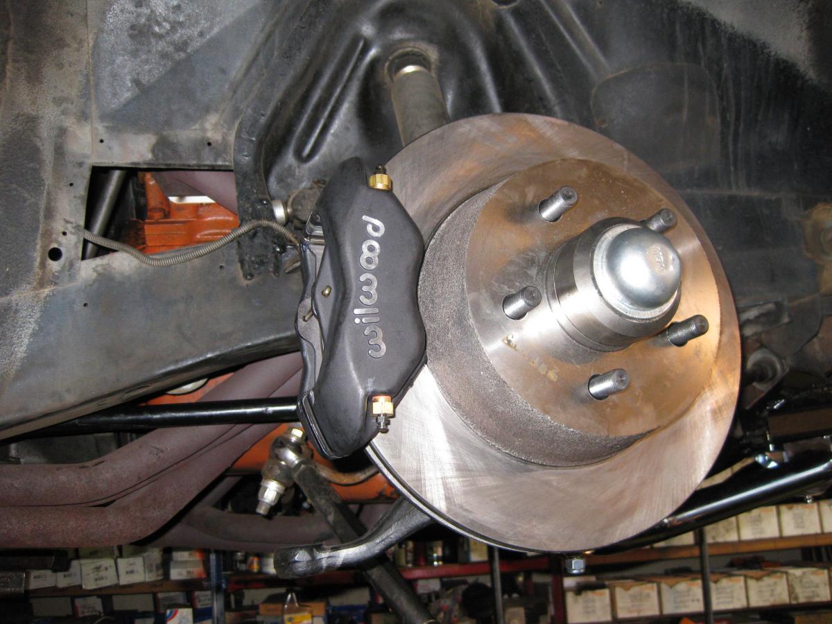

I went ahead and bought the Magnum Force drop spindles. It's nice because their shop is only 20 minutes from my house! I also upgraded to 11.75" rotors and wilwood disc brakes in front and used the caliper adapter brackets from AR Engineering. Everything fit together perfect! The drop spindles are well made and I think are a good improvement for my car. As soon as it stops raining in a few days I'll take the tires off and take some photos so you can see them. Here's one in the meantime....
