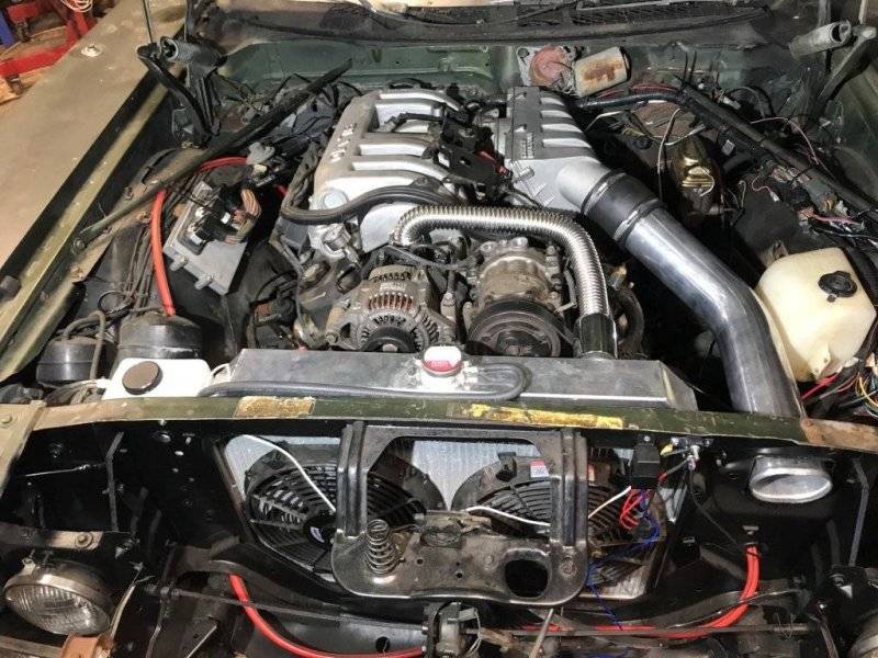

My fury is a boat and I added about 150 pounds to the front when I installed a V10 Magnum engine and OD transmission.
