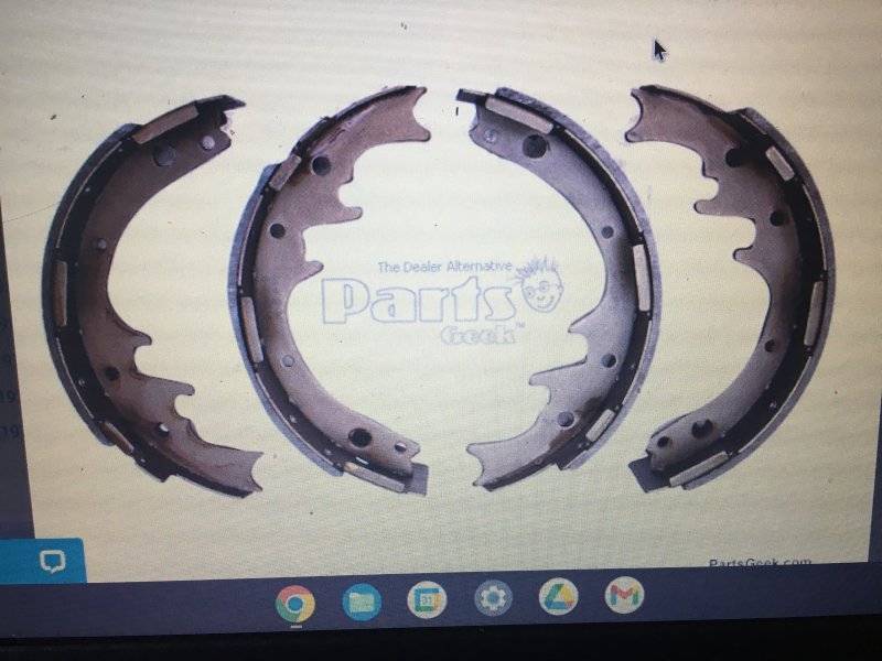

Well I am still struggling with this puzzle a bit. I found some local shoes with the primary lining where it should be but now noticed that these new ones AND the crappy ones I just took off don't have tabs or little bent areas on the shoe plate that line up with the contact areas on the backing plate. These are plain old 10x2.5 1964 Fury brakes. Did they make different contact locations for 10x2.5 brakes?? Yes I have the shoes in the right location. I ordered these the picture looks like it might work,
