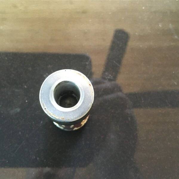

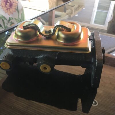

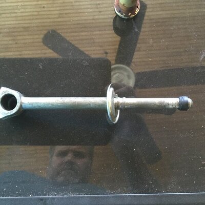

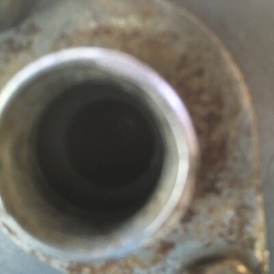

I am doing a dual master cylinder conversion on my 66 coronet 440 convertible.I have 4 wheel manual drums.I ordered a reproduction 809 master online.This is suppose to be correct for a b body with manual drum brakes.The master I received does not have the machined groove in the piston for the push rod retainer.Will this work with out it.I am thinking when everything is put together it can’t come out do to the stop at the brake light switch.Something tells me I should just send back and order one with the retainer groove.RamMan Inc.sells the one that has it.Any thoughts or has anyone had this situation?
There's a rubber piece that slips over end of push rod then you push it into master cylinder. If you try to remove it it breaks the rubber. Push rod needs a step near the end. Pic of yours?
Picture of rod and rubber piece.
I have the rubber piece on the end of my push rod.My problem is the new master does not have the machined groove the rubber locks into.
Does it really need to be locked in? If you install it after master is installed and bolted to pedal can it fall out? Had a similar problem but had an adjustable push rod.
If you do it as I did in earlier post. If rod can't be pulled out with you pulling brake pedal against stop how is it coming out? Some of the different ways to hold rod in maybe for production purposes. The rubber also for anti rattle. Only do what your comfortable with.
