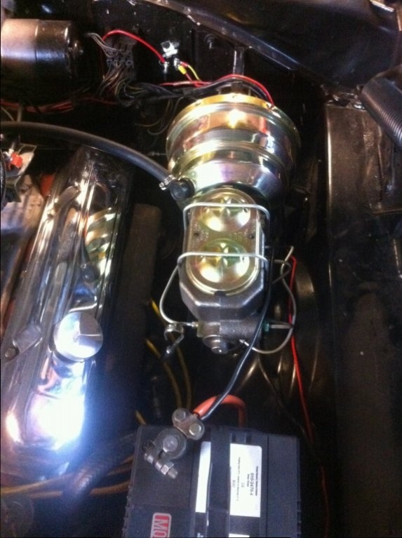

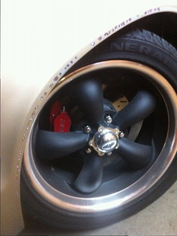

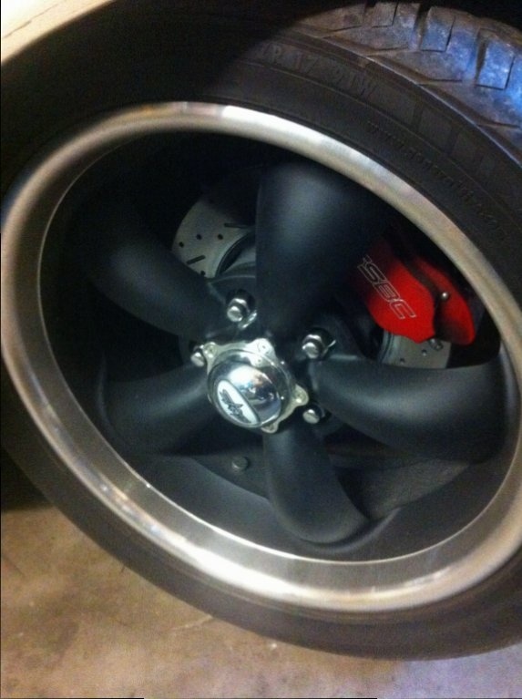

I ended up going with an SSBC kit on the front and the rear kit came from Summit. Very happy with the performance and plus the drilled and slotted rotors with the red calipers look awesome.
Installing the brake booster was a pain, mainly due to the new brake lines I had to install. But overall very happy with my new power assisted disc brakes.
View attachment 365217 View attachment 365218 View attachment 365219
