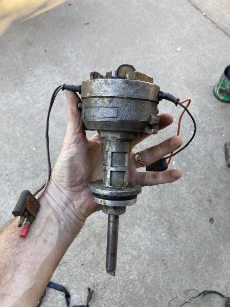

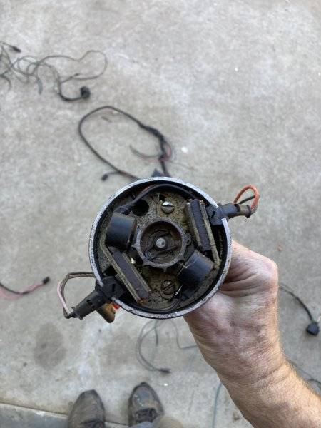

Found this in a box of spare parts that I got in a purchase years ago and can’t figure out what it came out of.
Anyone with any ideas?
I use them for some of the parts for curves or lock outs other than that not too many people run the lean burn ignition, it sucked. I have never even been asked for one in prob 10 years.
Yeah, I just walked my brother through killing one on his '78 New Yorker he has acquired.
Car has now been "converted". :thumbsup:
There are a few guys still running them, origional cars though they want to keep that way. I have pickups for them, but really the rest is a stock Mopar distributor. They are great for making lock out all mechinical distributors but to me not worth the ride I have a few
It might be useable with an EFI that does timing control.
BUT the reluctor phasing would be critical and I've never tried timing control with a Mopar sized cap and rotor.
Not sure how much timing angle could change and still get good rotor phasing?
I'd like to try it though... love a good science experiment.
They are usually right on. I have locked them out in the past.
