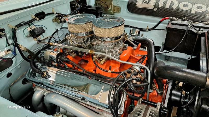

When I started with this system I had a 1406 primary and 1405 secondary. Anyhow I felt the carbs were a mismatch and jumped thru some hoops to get the clusters all squared up. I did do the lean primary thing and eventually had to keep jetting up. It would drive ok in town but would run rough and erratic after some highway time. Anyhow, I gradually made adjustments to improve all around driving and currently it runs sweeter than a bowl of peach cobbler. I also went after the idle jets. 1405 was .028 and the 1406 was .032 out of the box. Both carbs .035 now and that smoothed the low speed operation out nicely.
Next step is pair of 1407's hanging on the wall.
