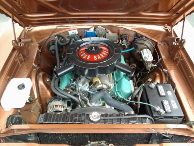

Hi - this might help - here is my 64 Dodge where I used the stock lid and a Mr Gasket base. I wanted to do this so I could have the stock look on top but have the larger carb inlet opening for the base. I think it's a 10" filter and it mates up to the stock air cleaner lid really nicely.
Here are two shots with both-

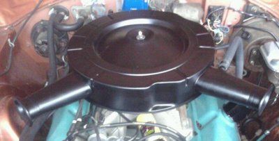

Yes you can, I have an Edelbrach hi rise intake on my 383 and for clearance to the hood I used a smaller diameter base and a narrower K&N air filter with a stock dual snorkle air cleaner it get air thru the snorkles and from around the smaller dia base.
Sorry only pic i have right now (blurry)
