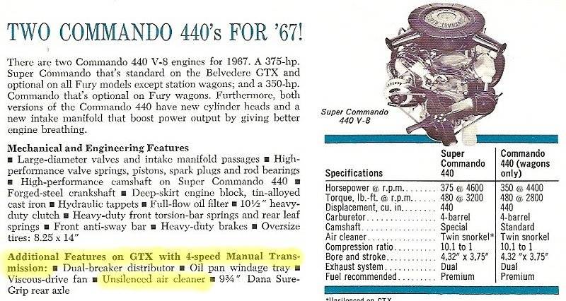

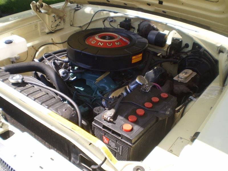

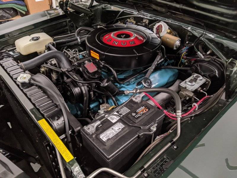

I have the large unsilenced no-snorkle air cleaner on my 1967 R/T. It has black wrinkle finish with red 440 MAGNUM pie pan. I like it because it is not as often seen as the dual snorkle one. Plus, when you nail the gas pedal, it says," WHAAAAAH" ! This air cleaner is more commonly seen on Big Block 1967-1968 A-body. I have some Chrysler engineering papers announcing the new High Performance 440 motor for 1967. In addition to all the spec's for the engine, these papers go on to say what special equipment was included in the package for the cars that received this engine. In these papers, it implied that 4-speed cars would get the unsilenced no-snorkle air cleaner, while the automatic transmission cars would have the dual snorkle silenced one. In actual practice on the assembly line, I don't think this was the case; more of "what's in the parts box today?".
I am not trying to pass my choice of air cleaner off as original; just what I like. My car was a very solid, complete roller when I bought it, missing Its powertrain. I was able to find a very complete, unmolested 440/727 out of a junkyard 1968 New Yorker at a good price, so that is what is in it now. I had the 350 h.p. 440 rebuilt to 375 h.p. spec's. and put '67 chome valve covers on it. No one has ever busted my chops about it, yet.

that's the one that came on my 68..... 440 auto

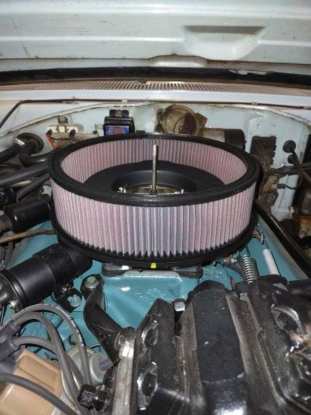

I had both. The tall version wouldn't even fit under the hood of the GTX. Even the shorter version would rub the hood pad but I think this was due to the previous owner running a 1" spacer under the Edelbrock carb.
Conversely, this owner also made a custom base to fit the Edelbrock as well...

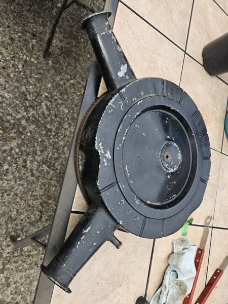

This one started life as a 67 dual snorkel someone had cut the ends off of. I cleaned it up and used it on my Charger. I later changed to a drop base from an unsilenced air cleaner, so now it looks stock and roars when you open the secondaries. I also feel it traps less heat around the carb than the original closed base.

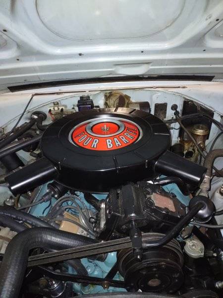

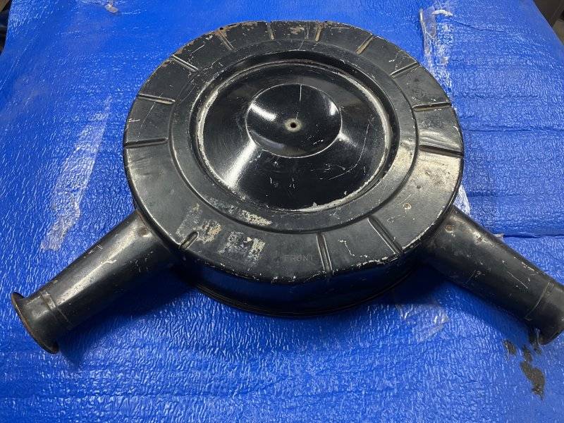

That air cleaner that copper67sat posted looks exactly like my 66 Chrysler single snorkel unit with an extra snorkel tacked on. I have 2 of those and was thinking about grafting on the second snorkel. Another tidbit, if you look at the shape of the lid compared to the others, these will not accept a pie tin.
Travis..
Travis..
Agree. Years ago I bought a pie tin thinking that the original had been lost by a previous owner, but it did not fit so I sold it.

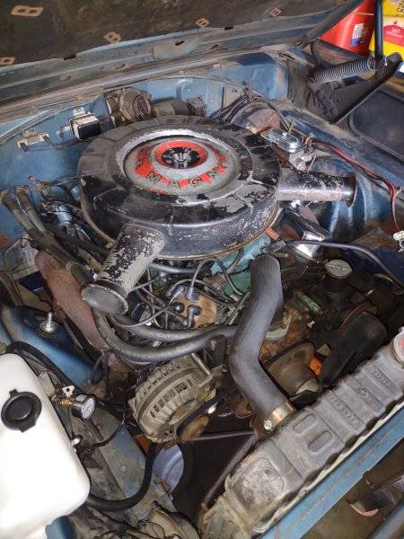

Here's the original tin... The car was driven nearly daily by the original owner for 15 years. It sat in his garage for 2 years before I bought it, and it's been in my garage for the past 40 years. I may have put 600 miles on it. It's pretty well 'weathered' by now. I sprayed clear lacquer on it to prevent additional flaking of the decal. Engine is now running for the first time after an 18 year sleep.IMG_20240817_145219507.jpg

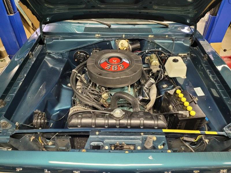

This is a 68 non pie tin, if it fits my avs 2 carb I will probably use it on my 67 coronet 383.
