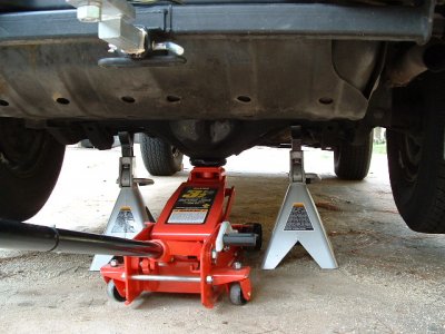

Similar to this:
I cannot remember if the wheel wells on the 68 will allow tire removal if you put the jack stands undet the axle as in the pic...so best to put them under the rear frams rails like I described earlier. Whatever you do, take your time and do it slowly. You don't need to drop 3500 pounds on you. That would suck.
