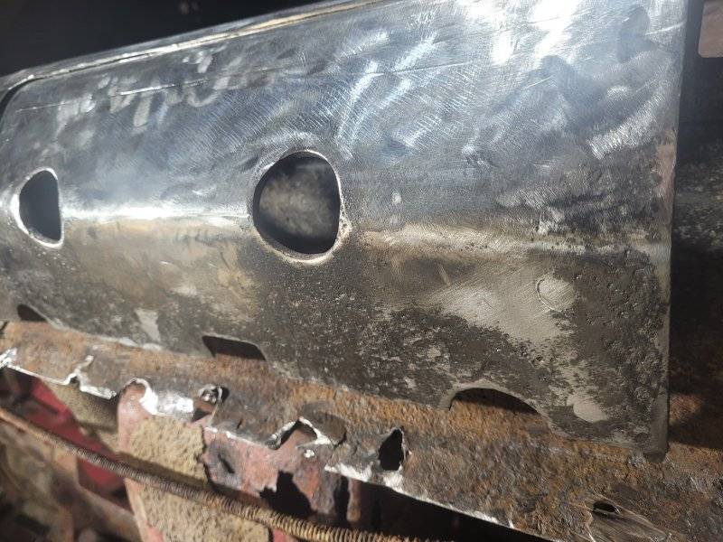

Sorry for the dumb question, but I've been grinding and wire wheeling this inner C-section for way too long and this dark discoloration just won't go away. The outer rocker needs to be welded to this. Is it OK to weld to this, or do I need to get more aggressive and get to shiny steel?
sometimes i just fab up a new flange, if the existing is swiss cheese
use weldable primer in either case, it's very corrosion resistant
straight Phosphoric on a rag use a prop to hold it slow but you will end up with clean metal
Even if you sandblast, I ALWAYS clean & grind with 120-240 disc till clean bare metal especially if Tig Welding. I use OSPHO for cleaning, made by Skybright here in Cleveland Oh.
Appreciate all the replies. I will probably give acid a try. It's a beefy hunk of steel, but I would still hate to grind off enough to remove the deeper pitting.
That’s why you blast it When grinding you take away metal that you need RC
Get some Ospho, great stuff you will use it alot, very user friendly. Wash the rust off with it, then wash the Ospho off with water.
If you want to be safe from potential fume inhalation, you can have a small fan near you to pull the air/smoke/fumes away from you. Especially if you've cleaned the to be welded area with brake cleaner or equivalent. Heat, UV etc turns the chemicals into Phosgene gas. AKA, nerve agent. Bad news.
