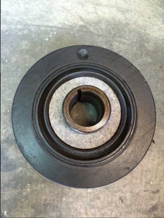

Replacing timing cover gasket on LA, pretty easy to figure it all out, but I didn't remove a dust seal from the crank/oil slinger, is it needed? and does it go inside the oil slinger, against the timing cover seal? Any help/pics appreciated. Thanks.

Thanks, but that's not what I'm asking about. I know about the oil slinger, and I replaced the crank seal... there's also a felt dust seal in the LA timing cover kit that fits on the crank inside the oil slinger, but I didn't remove one, so I'm wondering if that felt seal should be installed between the oil slinger and and the crank seal on the timing cover. thanks.
I figured it out, it goes on the outside of the timing cover inside the back side of the damper. Thanks!
