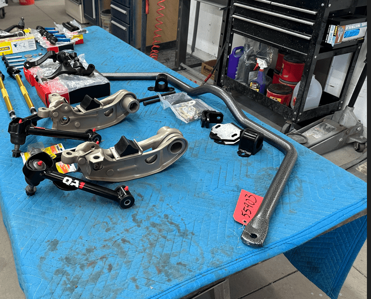

What car do you have that 55903 on? Summit says it won't fit my 72 Charger, use the 55904.
55903 -

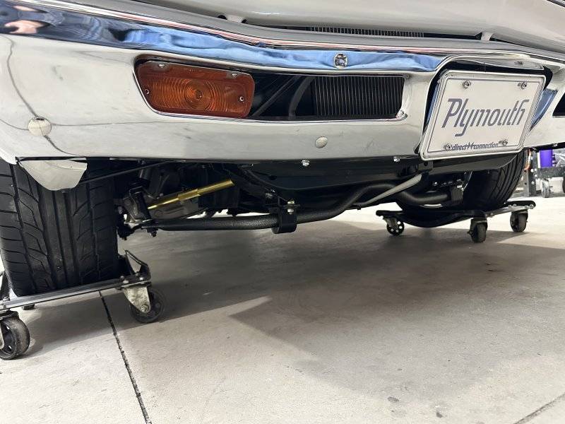

Will do. Hard to believe they are so different! Yours must mount somewhere around the radiator!
No, it mounts to the K-Member and LCAs. There is a bump in it to go over the support piece from the K Member to the radiator support. I'll try to get a full pic from the front, on the car.
68-70s are different cars on several fronts from the next generation. Apples and oranges.
No different than any other 68-70 B Body, just larger diameter because it's tubular / hollow.

Your car looks great! I'm surprised to see how far forward that bar mounts, and how low it is. Why?
Don't worry, we're doing "the weave!" We could come back to dust brake shields at any moment!
It does have 2" drop spindles on it but the bar is in the the stock location, nothing special.
