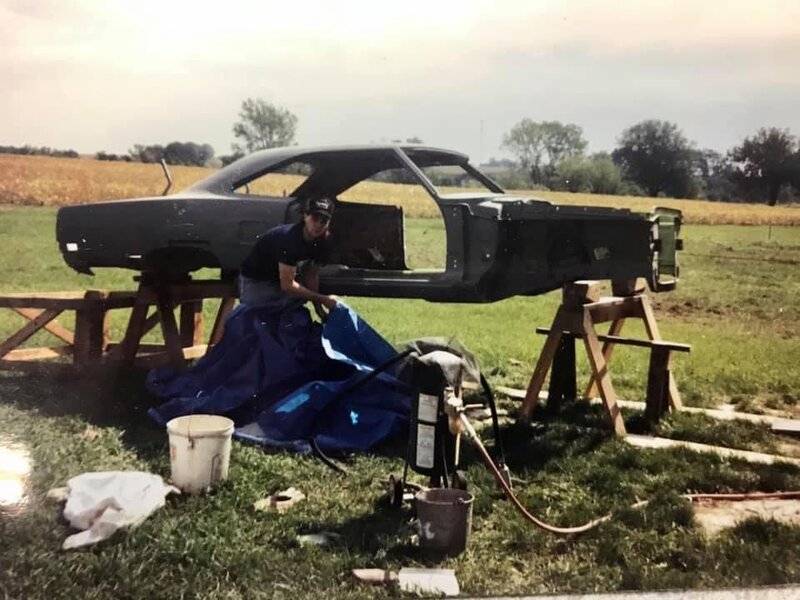

I did my first one myself 30 years ago with silica sand in a pot blaster for about $75. I’m looking to do another one and just trying to find the best option.
