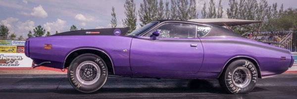

This photo is from the same weekend I ran the 10.14. I went to final 3 that day. Lost due to a bit of a nap at the light. Not much, but when you get that deep in rounds the competition is solid.
