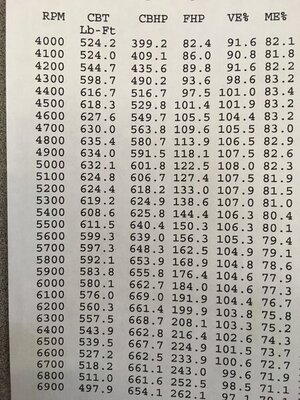

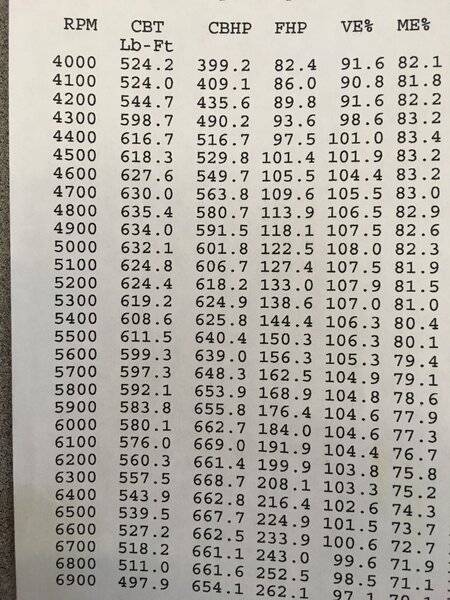

Dyno numbers are in!
Your peak torque is right where my 512 runs best. Similar build but with a M1 intake and 4500.

In the extension i think i have to get my heads ported to Max wedge or bigger if it´s possible and if there is any gains in doing that. I already had the carb and my first plan was to get one more 950 and smack on my tunnelram, but it became a money issue so i just got the Trickflow intake. I do have a cheater nitrous plate under (150 shot), but that will on be a "if needed" option lol

the engine didn´t make power above 5300 there was no point in increasing rpm (i still wanted to pull it 6K) It was a 1 7/8 dyno headers, i run 2" fenderwells in the car.

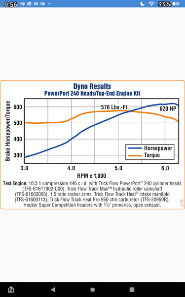

Just compared it to the TF top end kit that made 576TQ/620HP, you have more 1 point more compression and a bigger cam, yet they peaked HP around 6200.

Yes but i also have more cui than that test engine, and bigger needs more. So even if the heads have pretty good flow maybe they don´t have the area enough to flow that amount of air that my cui needs.
I guess that was what I was eluding to , but also thought it would have been made up with the larger duration and lift. Could it possibly be the maximum flow is reached?
Also found it interesting that Hp//Tq were almost exactly inverse and that the rpm was down so much compared to their 446.

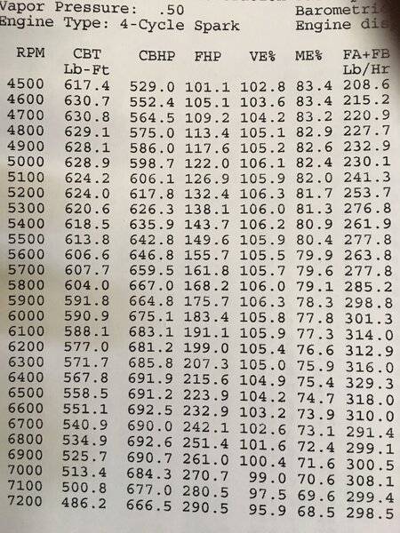

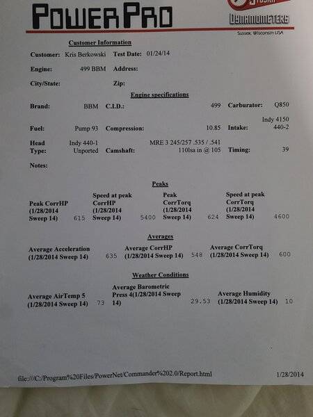

I would have thought that the dyno sheets I posted, of nearly 500 cube motors, with std port heads(that flow less than TF240’s), topped with std port manifolds....... making peak hp at well above 5500 would have put the notion to rest that you can’t make power above 5500rpm with that combo.

I was actually more referring to the two SR headed builds making even more power than the 505...... at even high rpm.
Yes, SR heads are std port....... unless you make them not std port.
Those two builds were still std port, being run with unported std port intake manifolds(that weren’t as good as the new TF manifold).
The main point being....... there are ways around the low peak rpm the OP was seeing with his build....... that don’t require having the heads brought out to MW size.
As for the 505......I have no doubts that if one built that exact same combo, but with TF240’s on it instead of the RPM’s(they didn’t exist when the RPM’s for that motor were done), that the numbers would be better acrosss the board.
