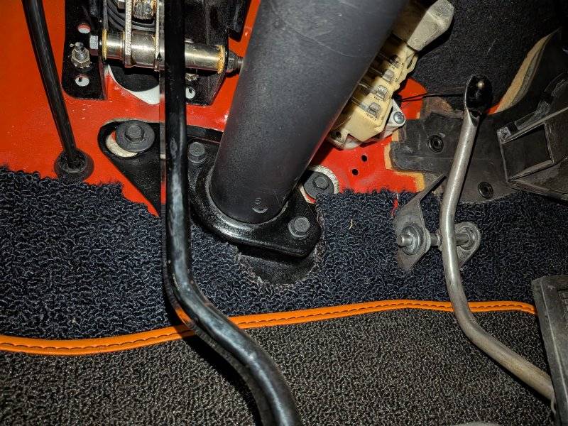

hello all
does the steering column three bolt flange to firewall go under carpet or over thanks sjm on e body challenger
hello all

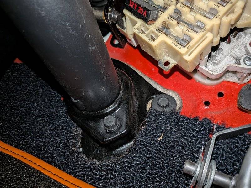

The flange mounts directly to the firewall with a foam gasket and the carpet goes over the flange. The following images show an example:
