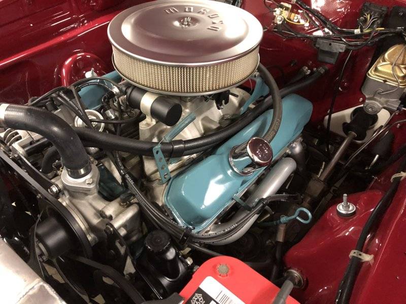

I’ve got stock steel valve covers on my B engine with Edelbrock heads and Comp roller rockers. No evidence of interference and no leaks so far.

Edelbrock heads, stock steel valve covers, I guarantee you there are roller rockers under there with no marks on the baffles. Comp XE274 cam so it’s no extreme high lift.
