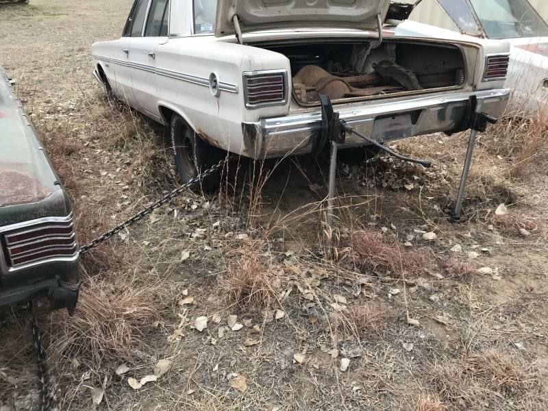

Some people with air shocks with a bottlejack jack down the spring. Regular shocks you remove shock from shock plate and jack spring. Had L60 15"s had to do that, never had to do that on the road, no flats traveling. If you look at rear tire you can see how close tire is.
