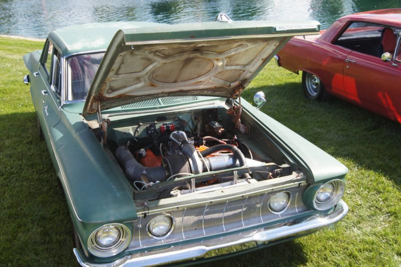

We run E85 in a boosted 360. Have run up to 20psi with no detonation,carb and no intercooler . Constant checking at local stations has always been with-in 1-2%. We race on it, very consistent. Drain and flush with gasoline over the winter. We also run aluminum fuel line with no issues. 9.80's@138.
Doug
